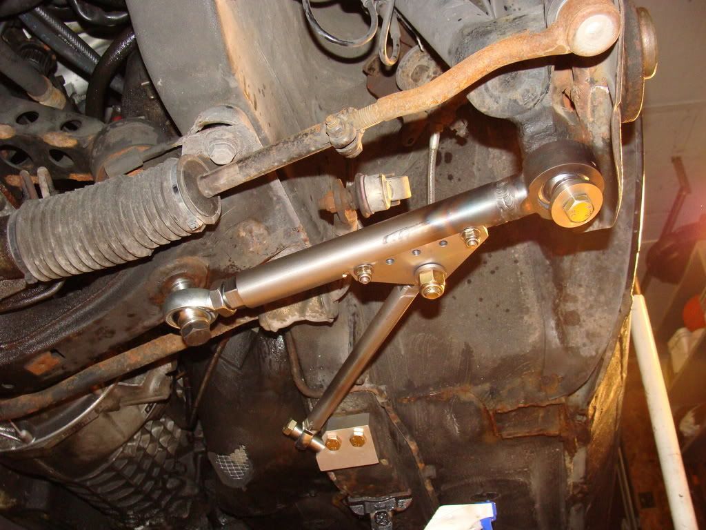

Quote from: romkasponka;106061
Instal front aluminium arms from E46 and you will get good caster camber and mass reduction in suspension moving parts, that will increase grip and so on... ;)
I was thinking something more like this:
Both rear control arms shoud also be tubular and adjustable type :)
