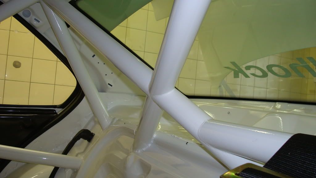

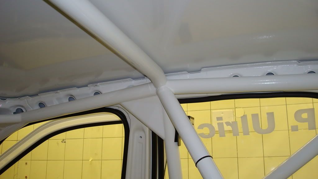

i would say.. stitch-weld the whole chassis.. all seems you can find.. first clean it from colour and then.. WELD WELD WELD.. have fun.. there are at least 100km of welding in front of you..
thats what i am gonna do with my white car.. and then a bolted rollcage and strutsbraces front and rear.. i think that all will increase the rigidity of the car more than enough.... perhaps a sheetmetal here and there too.. :D
