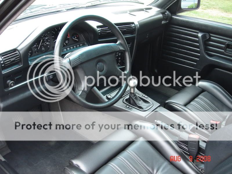

Disconect the battery.
Remove the 2 t25 torx to take the bag off(behind steeering wheel)then  unplug it.
Then remove the 22mm nut and off with the wheel.
There one plug in the column you have to pop off the cover to get to.
I used the factory spacer from another car.
then put that on and the original washer then nut on top.
There was no good info or pics I could find hopefully this will help everyone else.
My hub adapter was the momo 2006.
This probably would work for a Mtech series wheels too.
Much better
