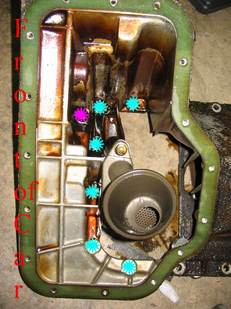

With a flashlight, look up into your pan. Laying on your back, you should see something like this:
Inside there should be 6 bolts.
The thee bolts closest to the dipstick along the front are the 3 most important ones we are looking for, however you obviously want all of them. Blue designates a pan bolt.
Pink designates the hole for the dipstick.

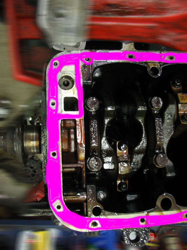

If you were to remove the upper pan, this is what you would see with an
overlay of the gasket.
Here you can see the little extra piece that goes around the oil pump pickup. As you can see, there is really nothing to hold it in place other than those front bolts (terrible design in my opinion).

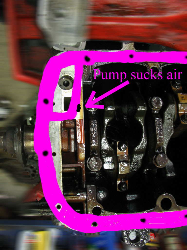

Here is what happens when those bolts fall out.
The pan gasket shifts forward, allowing the pump to suck air from the oil pan.
On this engine, you could actually see a small tab of the gasket hanging out in front of the block.

For the curious, here is a shot of the block as you see it without the upper
pan and gasket installed.
