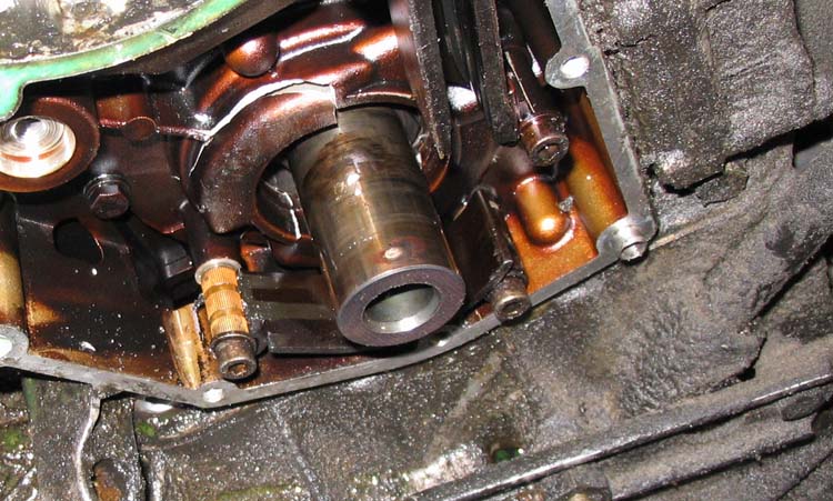

Pulled the front end apart today, 2in crack in the oil pump housing, and one chain guide is pretty much destroyed. All sprockets are worn to shit as well.
Several factors I think led to this, at least some could be atributed to the new timing chain tensioner.
Pics in a few hours of the pump at least.

Put in a new writeup.
Heres what I found.
I think I brokeded it.
