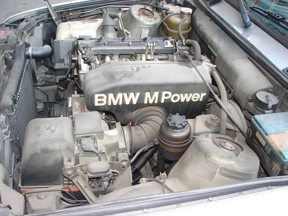

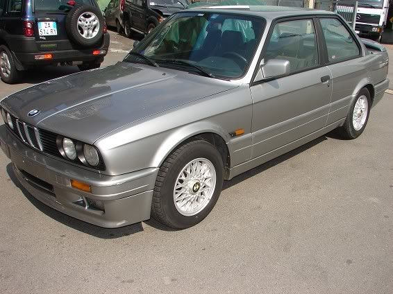

320IS model for portuguese and italian market was basically a 318IS with 2.0L S14 engine.
Both 320IS and 318IS have suspension, brakes and all other undergarriage parts directly from 325I model.
320IS 2-door models had M-tech II body and BBS style BMW wheels as a standard. Also 4-door version was available without any spoilers; it also had 14" bottlecap wheels.
here's pictures of one italian (from South Tirol) example i almost bought last summer:
Here's few 320IS examples for sale in Italy:
