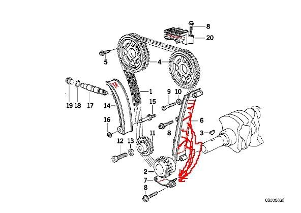

After removing the upper and lower timing case covers I found that the long guide rail and the lower guide are BROKEN! Also I have visible wear on my upper guide and the tensioner guide aswell. Kindergarten pic follows:
*The long guide rails pieces where all smushed up above the lower guide.
- The chain looks fine and all gears and sprockets look fine aswell. (Not too sure about crank sprocket as it comes pointy new, correct?)

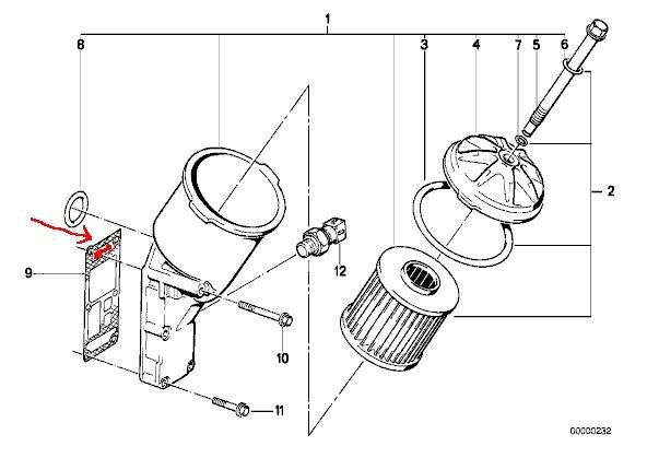

Another issue I ran into was when I removed the Oil filter housing. When I removed the housing I noticed that the top area was PACKED full of sludge mixed with shavings (from my chain rail?) The housing itself and the area on the case where it corresponds too is clogged aswell.

2. Another thing too is that the tensioner rail/guide has the plastic ''pitted'' at the top and the top guide has visible wear from the chain. Should I replace these two parts aswell?

I'd replace the timing-chain while you are in there, it must have taken some abuse.  It's not very expensive.

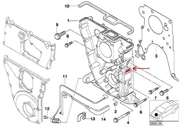

I pulled the pan and sound some metal pieces and LOTS of sludge around the pickup. This could explain alot of things.. I noticed aswell that the there was alot of corrosion with the gasket between the lower timing case cover and the block. I have everything apart now so I just have to deal with parts.

Roughly $450 bucks for above mentioned parts. Prices were from Pelicanparts.. I hate this car. :(

This thread has what worn gears look like .The chain and associated sprockets should be replaced as a unit if they are worn.
good luck
http://www.m42club.com/forums/showthread.php?t=4629&highlight=timing+gears

My cam gears are fine.. I just need to know what the Crankshaft sprocket looks like in good condition. :/

« Reply #6 on: March 17, 2008, 06:00:09 AM »
It should look like a good cam sprocket............ no sharp points .............
