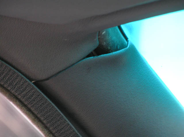

Say what you will about the ricer look, I honestly prefer my gauges where I can see them without taking my eyes off the road, and since I use my AC occasionally:
This is the Lotek gauge pod for the M3, picked it up several years ago. Only fitment issue is at the very top, it doesn't quite match the contour of the original:
It's close enough that it's not all that noticable unless you are looking for it.
