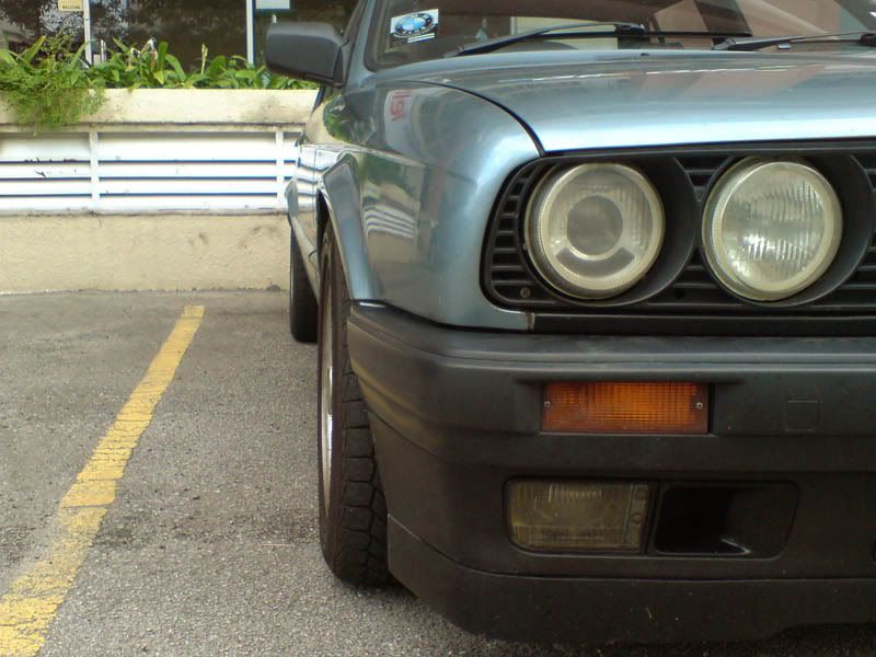

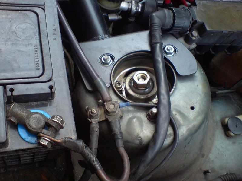

Took some shots just now...
As you can see, I didn't dial in much camber but the front bites well enough even for track days... Tyre wear is pretty even for the front..
Anyway, just sharing.. Don't think it's feasible to ship anything heavy half the globe away... Furthermore, the top nuts are different for different types of shock absorbers... some have 12.5mm thread and some 1.5mm thread..
oh btw, the IS lip you see in the photo is actually beaten out of sheet metal...

Quote from: fabe;43960
1,25mm and 1,5mm I think..
p.s. dont you think you should add some grease?
« Last Edit: March 02, 2008, 02:51:27 AM by romkasponka »

« Reply #20 on: March 02, 2008, 12:21:56 PM »
how much of a negative degrese is that, do you know?
fabe
  • Posts: 197
Adjustable front camber plates
« Reply #21 on: March 02, 2008, 07:17:06 PM »
Quote from: twism;43977
Should be about -1.5 degree...
