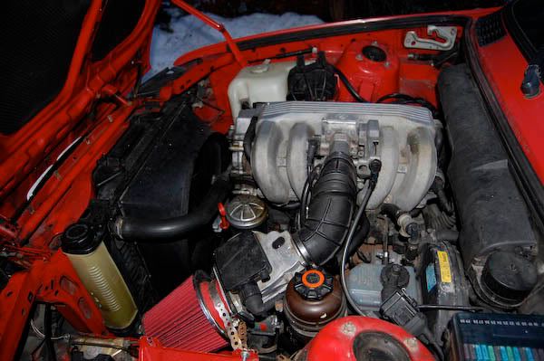

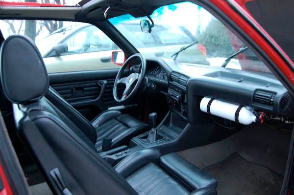

i will be performing the restoration of my brilliantrot 318is soon. i thought it would be best for all if i could keep my progress documented in a single thread.
here are some pictures of the car

You may want to put off purchase of any timing chain/timing case-related parts until you pull the valve cover and inspect the sprockets.  If those are worn you'll need to replace them too.  Maybe even one or more of the guides.
Also, not sure which route you're planning to go with regard to the mess under the intake, but whichever one you choose, plan on replacing at least that plastic pipe (which will be brittle and/or rotted), and all hoses under there should be replaced.

also as i took off the manifold i took it to my auto class and beed blasted the manifold to get rid of all the cosmolean that is put on the BMWs at the factory then just clear coated it and it looks like brand new aluminum (the clear coat is to preserve the look of the aluminum otherwise it would tarnish and look ugly again i plan on doing the same for the valve cover but its a little too cold out lately
i will do so. i'm thinking the worst could happen when i open the engine so i'm ready to install new sprockets/guides if needed. i don't want to have to open the engine often. the car has to be relatively reliable for another 100k. as of now it has only 153 000km (95 000miles) so they might still be good. who knows. i hear a little metallic ticking sound though thats becoming more and more noticeable especially when cold.
the mess under the intake will go. i want to remove the throttle heater plate since this is going to be a summer car once i'm done with the restoration and  the one thing i appreciate about cars is when the engine bay is clean, clear and easy access so that mess has to be sorted out and organized/restored

-a little 1/4'' flexible and clear plastic tube will run from the extinguisher to the engine bay (directed to the injectors and to the exhaust manifold) so it can be acuated from inside the car (if ever there's a fire, opening the hood allows the fire to breath and amplify since it creates a chimney effect) i hope to never use that mod
