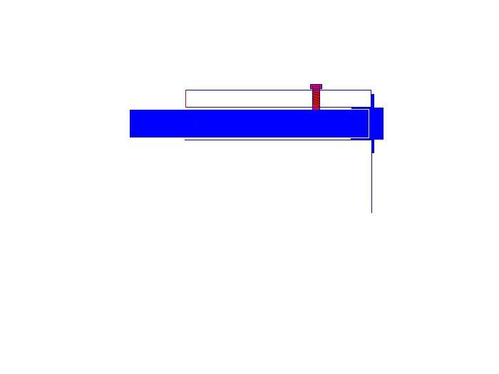

« Reply #17 on: January 01, 2008, 02:13:26 PM »
i dont have a picture or a drawing... but it is quit simpel. it is a specialy made screw (no spring inside) that replace nr.17. with this screw, you adjust nr.14. and then you lock the hole thing with another small screw on the side of the new nr.17 so the screw cant turn out anymore.

can you make a sketch with paint? :)

i can try..

tata...

what about just taking the existing cap, drilling and tapping a hole in the center of it, then use a threaded rod (a wheel stud seems like it would be about the right length and most of them have holes for a hex wrench) then use a nut on that to tighten against the cap so the rod doesnt move. I dunno how all this would affect oil pressure though

the piece i am telling, nr.19 and nr.17 ar one piece. so you can screw it in and out and then you can tighten it with the red screw
