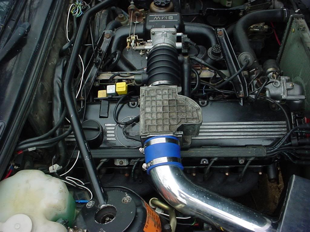

That looks remarkably like an M30 throttle body.

thank you justin, who know if M30 TB is a bolt-on affair? What is its diameter?
I remember reading 63mm stock and the 633 guys were doing a group buy for 66.x mm bored out throttles.
I don't think its a direct swap because the bottom of the M42 throttle bolts are further apart than the top. But at least we know that the top bolts match up. M30 TB gasket is essentially square.
http://www.autopartswarehouse.com/search/?N=9740+1580+4294967005+7004
VS M42 heater plate as reference.
http://farm3.static.flickr.com/2273/2113768490_0e79cfd0c4_o.jpg
So you will need to use an adapter plate. Maybe a very thin one.
One way to look at it is the that the M42 has a 35mm + 54mm tb or 1.37" + 2.1" TBs. The M42 total thorttle surface area is 1.47"^2 + 3.46"^2 = 4.93"^2. The M30 has a 63mm or 2.48" diameter throttle plate with a total surface area of 4.83"^2. So in rough terms the M30 TB is marginally smaller but thats not the whole story. This doesn't take into account how the air flows through 2 different size TBs instead of one large TB. If you put both TBs on a flow bench I suspect the M30 TB will be more efficient. I'll pick one up at the JY and give it a try.

thank you justin. I was thinking that M30 TB was bigger than 63mm just looking pics...

The top half of the manifold could be from an M43 but the bottom half has to be from an M42/44 because the bolt pattern on the head. The TB still looks to me like it came from an M30.
