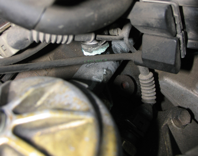

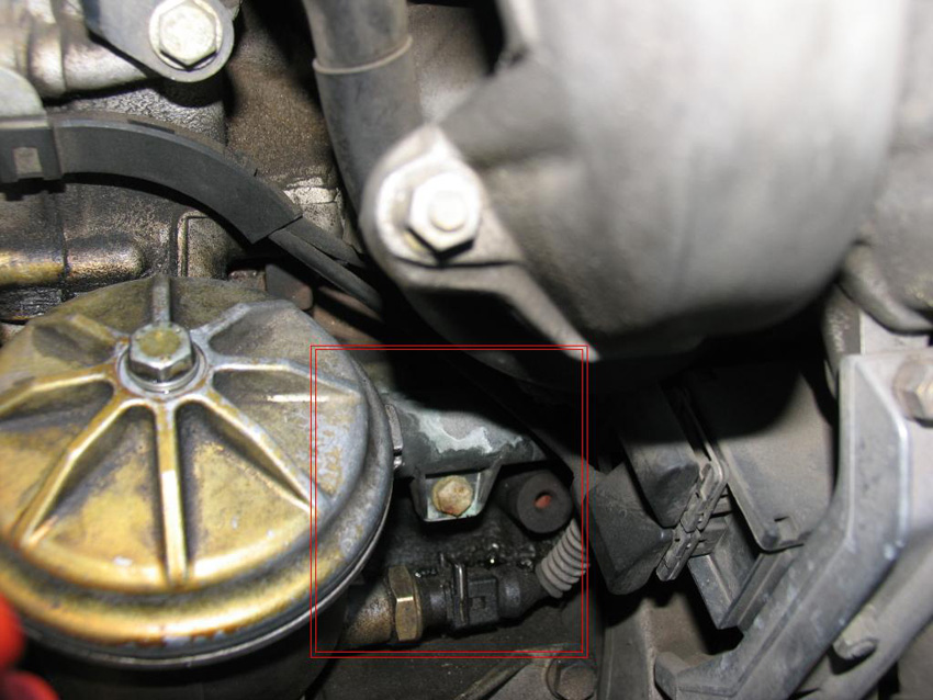

Just noticed a puddle much larger than the one pictured below that appears to be a coolant/oil mixture.
Is it a water hose? Seems as if the clamp is loose. Pls excuse my n00bness :o

Yeah, that's a water pipe (hard plastic) but realoem.com doesn't seem to show a part number.  You can try tightening it, but be careful - you don't want to crack it.  It's probably just coolant, but it has mixed with the oil you appear to have all over the back side of your filter housing.  Clean that off!  :)
I have a brand new one sitting on the shelf in my garage, I can get a part number off of it tomorrow if you like.
[EDIT] Found it!  I knew I had found the part number before - it just isn't in the COOLING section. Go to realoem.com for your car, then navigate to ENGINE -> ENGINE HOUSING -> ENGINE BLOCK MOUNTING PARTS.  It is item #1, 11531714738.[/EDIT]

Nope, but I recognize the part from when I stripped the intake manifold off and replaced all the rubber lines.  I bought another one of the tubes 'cause they were cheap and I didn't want to get half-way through the job and have to special order parts. I've kept it because I intend to replace it the next time I am in there...  whenever that may be.
I would recommend cleaning that area with a good degreaser (POR-15 Marine Clean or Simple Green), seeing if you can tighten that fitting, and driving some more - see what the leak looks like, if it is still leaking.  If it isn't leaking, you're good.  If it is, I would bet it is just coolant. It looks like that pipe may have been leaking for a while, judging from the buildup on it.
You haven't noticed oil in the coolant tank, or coolant on the dipstick, have you?
