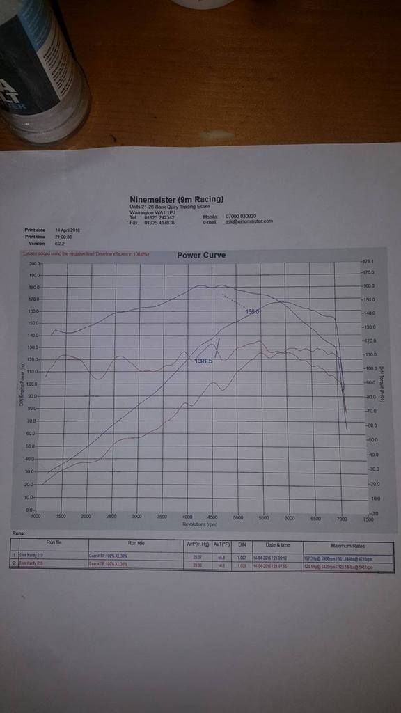

so here is the graph. 167bhp and 161ft-lbs
ive given it a quick blast earlier today and im very happy. now ive driven id say its pretty much what I was expecting.
I think with itbs and abit more of a aggressive cam (not much as the torque is fantastic) it should be a brilliant engine.
And it sounds fantastic inside!! and with the e36 box and 4.45 diff it gets to 100mph in absalutly no time at all!! quite scary really!

Great that you finally got it tuned!!  Are those numbers actual power or rear wheel power?
Maybe you could post your complete build here again? Crank, rods, valves, cams, etc...

I havent spoken to the guy that mapped as I/family run a breakdown recovery company and one of our drivers was passing sohe picked the car for me. so im abit confused with the graph but I would have thought the figures were at the flywheel. the bottom table shows lower figures of around 130bhp. not sure on torque.
itcurrently has these regrinds http://www.kentcams.com/product-details/98/Camshaft/Camshaft/BM48-Sports-Injection/

From what I have seen of your build I would say that's at the wheels!
