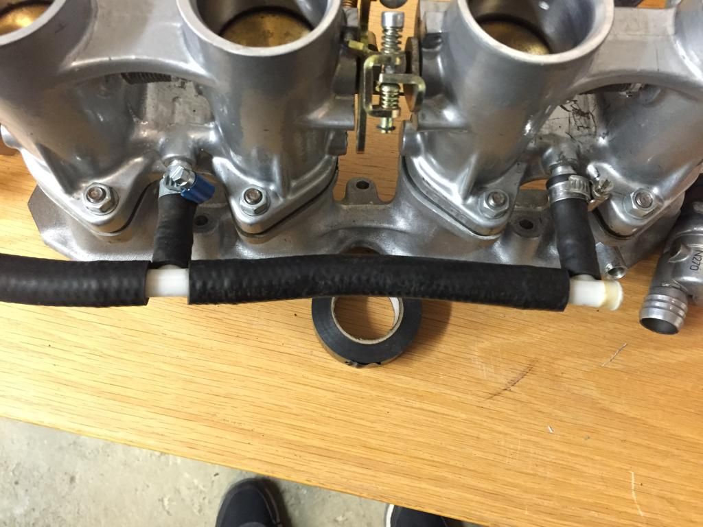

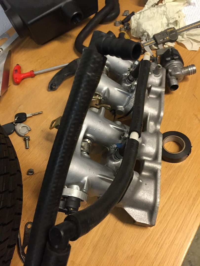

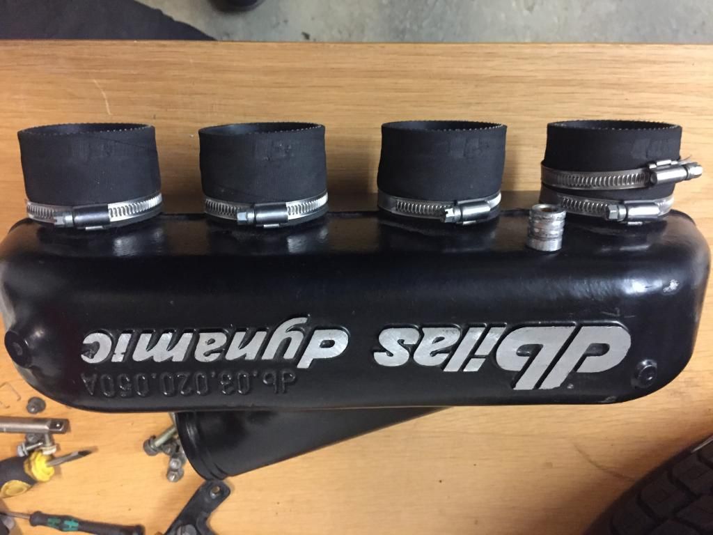

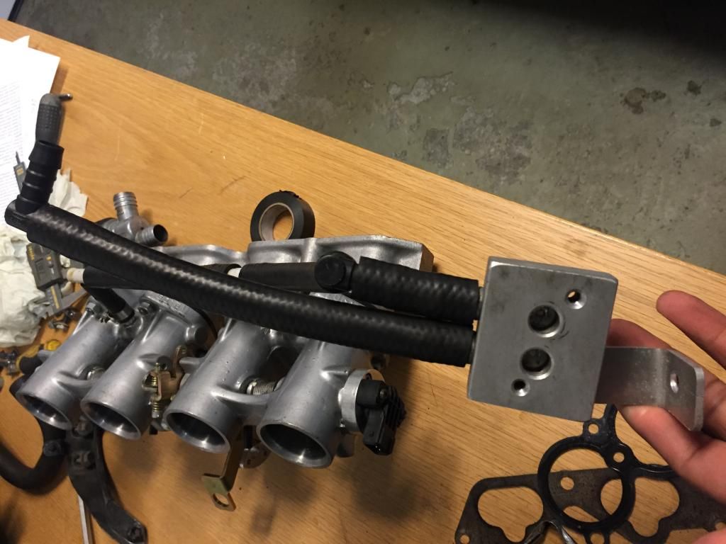

Hi, I'm from Norway and bought me a Dbilas Dynamic suction to my E36 318IS. But I have trouble fitting and wonder therefore if any of you have done this before or can help me?
Where do the fit the idle actuator motor? On the mainfold and airbox, it is two small plugs two mount the hose from the idle actuator motor?
The fuel lines, ice not easy to mount perfectly. I have tried two bends it, but in gets a twist in the middle. Do you knowwhere i need two bends it?
Do you have any pictures from fitting dbilas intake mainfold on m42b18 engine?
I think possibly That I have Dbilas Dynamic intake mainfold two M44 engine, while I have the M42! What are the differences Dbilas Dynamic intake kit two M44B19 and Dbilas Dynamic intake kit two M42B18?
Here is a picture of my kit:
Best regards - Sinthur.P

Re: M42 - URGENCY -I Need help to fitt Dbilas Dynamic Itb ??
« Reply #2 on: March 09, 2015, 01:40:37 PM »
Hi Sinthur,

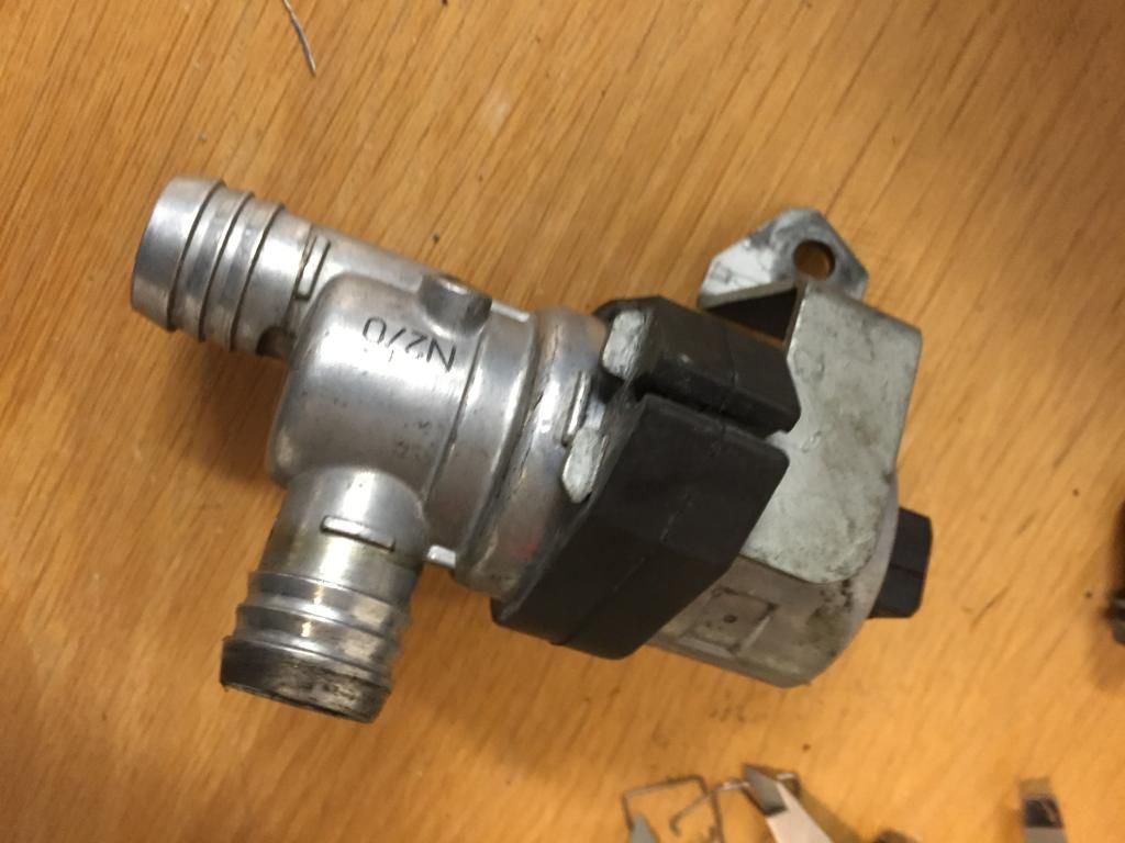

I can answer you first two questions:
The idle actuator motor is connected between the air box and the throttle bodies. On the lower section of the air box there should be a spigot protruding, this is the inlet path for the idle valve. Connect this spigot to your icv directly via a tube paying attention to the air flow direction arrow on the icv. The outlet of the icv needs to be split in two with a tee piece. This allows for connection to the air inlets under the throttle bodies. Look on the underside and you should see two spigots protruding between cylinder 1-2 and 3-4. Each spigot is internally drilled to supply air to each runner.
The fuel lines are difficult to fit, in order to fit mine I had to modify the fuel rail by giving the attachment spigots a gentle twist upwards to give clearance. I then deleted the hard lines on the block and replaced them with rubber tubing back to the fuel filter and return lines. Ensure these lines are secure and preferably protected with a stainless braid to avoid wear.
I do not know the difference between m42 and m44 kits but suspect its minor if anything.
There are pics in the links in my signature which may help also

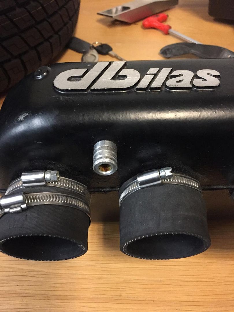

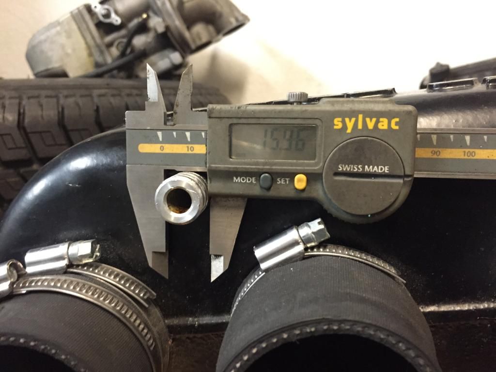

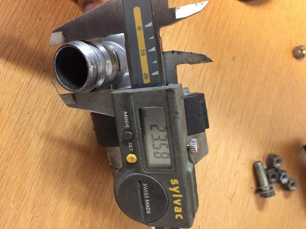

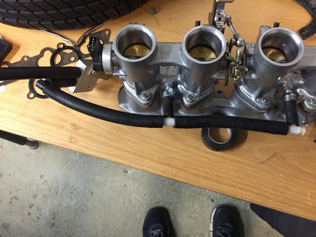

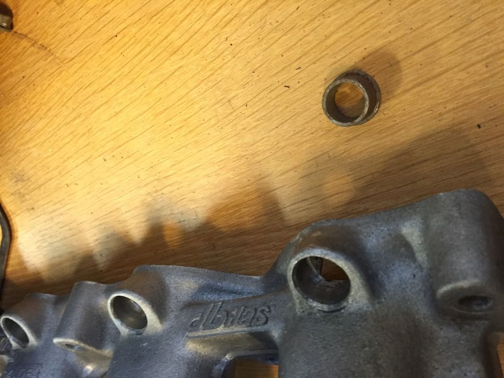

I still have a few questions:

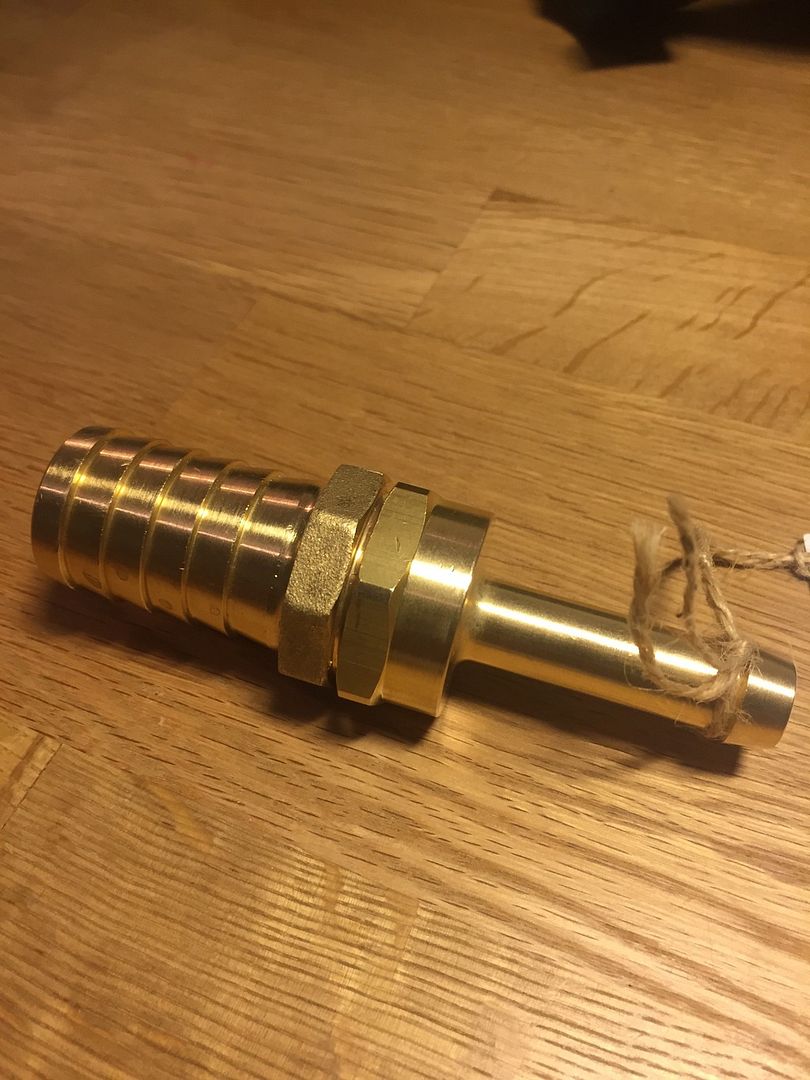

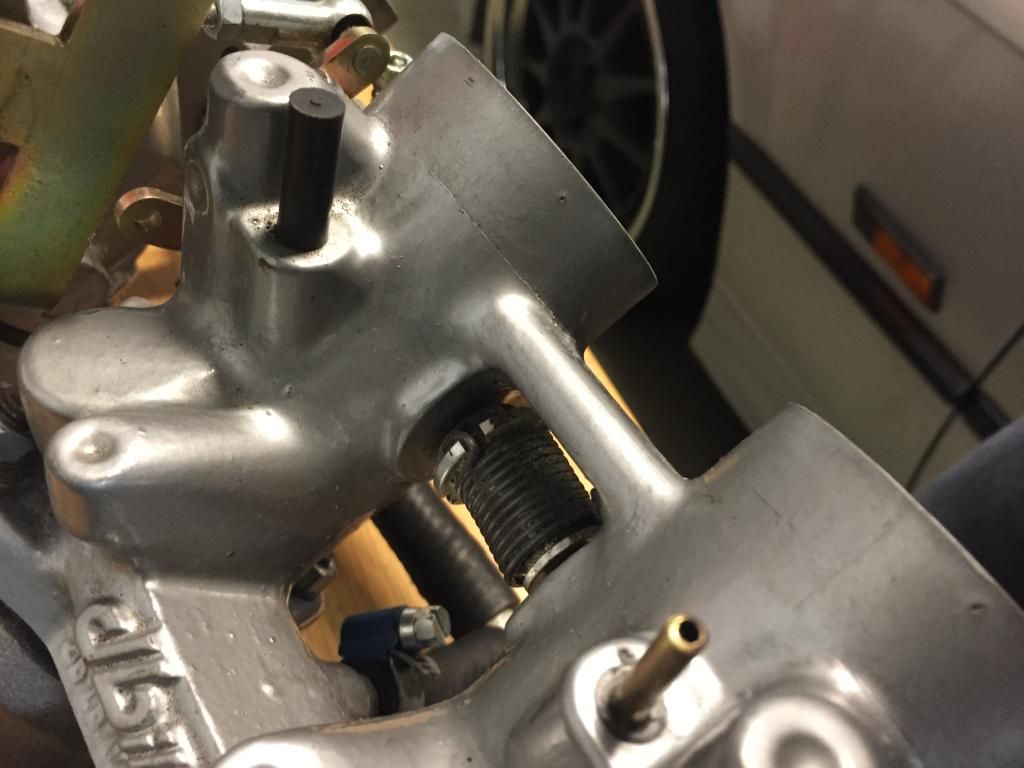

-On this plug I should connect the hose from the valve cove, right ?

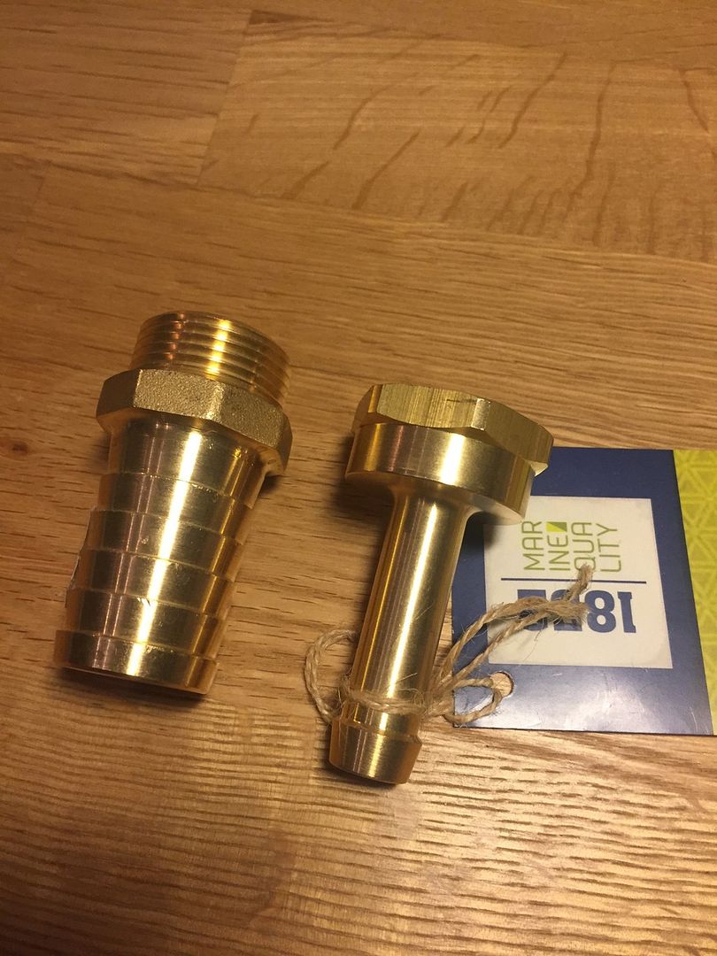

-On this plug i should connect the hose to the icv, right   ?  But it is to small to fit bolt on ? Should buy i custom hose that will fit ? A hose with 16mm to 24mm ?
-ICV

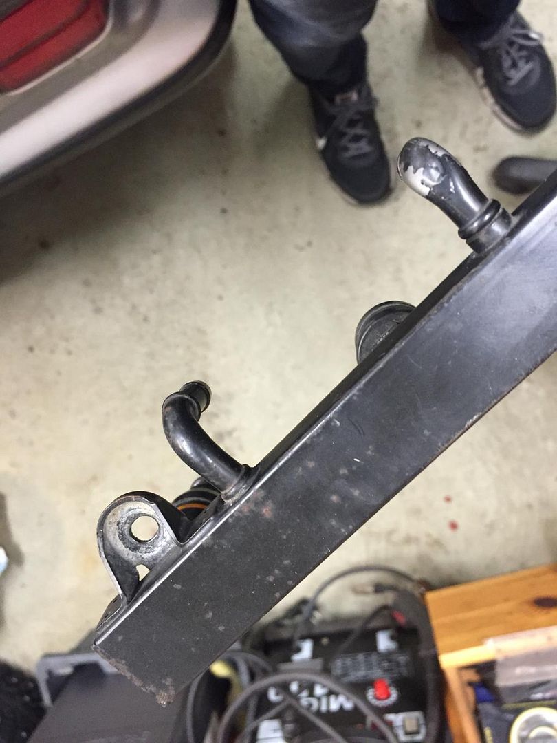

-I managed to bend to gasoline pipes, but I must correct the out slightly.

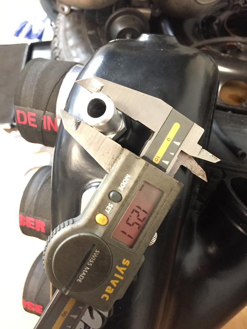

-Is this the to plugs that i should fit the output hose from the ICV ? What is the small plug to the right with no hoses on ? What should i fit on that one ?

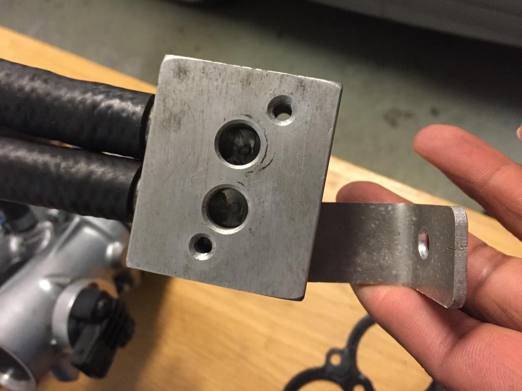

-What is this hoses and the metal modul ? Do i need them ?
-Which hoses should i put on the plugs (there are four plugs) ?

« Reply #5 on: March 09, 2015, 06:36:53 PM »
Have answered in red below.
 Yes the 16mm is for the valve cover breather
You mean 12.5mm to 24mm,  I had to go to my local parts store to adapt something to make up the size difference.
BE careful here. The pipe appears crushed and may not seal well. Before you start the engine monitor this area for fuel leaks when fuel pressure is built up and then keep an eye on it after start.
Yes correct. The spigot on the right is for your brake booster.
I bought my kit from a member on this forum and did not include the metal module. It appears to be a distribution block but to what I do not know. I think this can be deleted without issue as I do not have one
Connect one to your fuel pressure regulator and leave the remainder blanked off. If you find pressure is unstable due to intake pulses you can link all four together to smooth the signal. I did this by default but suspect it is not reqired
Cheers
Matt

As for the bent fuel rail pipe, if it were me, I'd be looking for a replacement because that does not instill confidence... :)
*Yes  i mean 12.5mm! I think i know about i shop local that sell adapters.
*I'll do it! Maybe I buy a new gasoline line and trying to bend a little more careful.
*Okey!
Good ! I would try without!
Okey, i would try with one first!

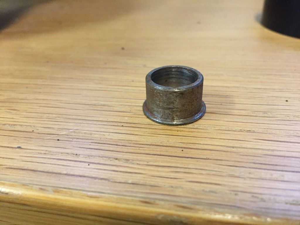

The spacer to the fuel injections, how do i get them 100% sealed ? With some tube gasket between ?

Thanks for the mounting instructions! It was much better than the one I got from Dbilas!
I have bought parts to make a transition from 24/25mm to 12,5 mm !
