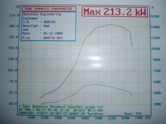

« Reply #8 on: January 16, 2007, 07:14:10 PM »
m42 with some work done to it.... :p

« Reply #12 on: January 22, 2007, 04:01:58 AM »
Quote from: kowalski;17691
what kind of work?
Motor:
Custom 8:1 pistons (JE Pistons)
Cometic steel head gasket
whole engine machined and balanced (new bearings seals etc)
Garrett GT2871R turbo (running 20 psi max)
3inch exhaust all the way through
lancer evo front mount intercooler (unsure which evo model)
Wolf3D engine management
M&W igniter
oil catch can
custom turbo manifold
standard rods
standard cam
standard valve springs
Driveline:
8 bolt LSD 3.91 (prob change to 3.46 soon)
custom 4 puck clutch disk
custom fitted Ferrari 355 pressure plate
318i flywheel
316i E36 gearbox (cheap fix for now, first one blew after 80Km's)
Others:
greddy boost controller
boost gauge
E36 electric radiator fan
To Be Fitted:
NOS system
Currently the car is putting out 213Kw at the wheels.
a few days ago i took the car to the drags and the best time i could
run on 20psi and my stock tyres was a 12.9sec (quarter mile)
i think i can bring that down a touch more.

why would you go to a 3.46 rear end?
how is the turbo lag on this thing?
and what kind of LSD do you have in it?

A 3,91 gets real short when you have serious power,
a 3,46 would probably fit the bill perfectly,
