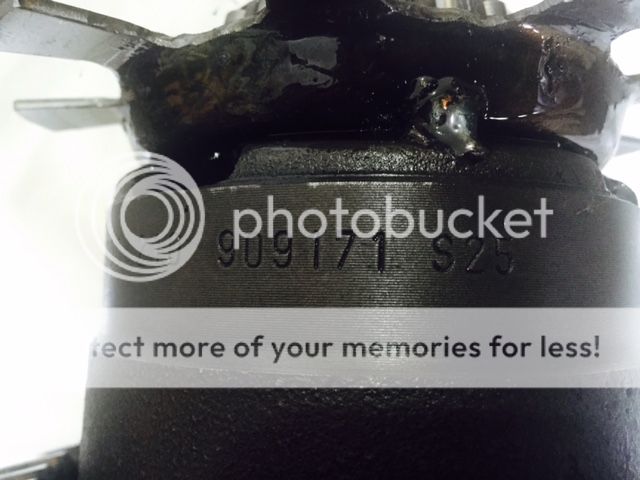

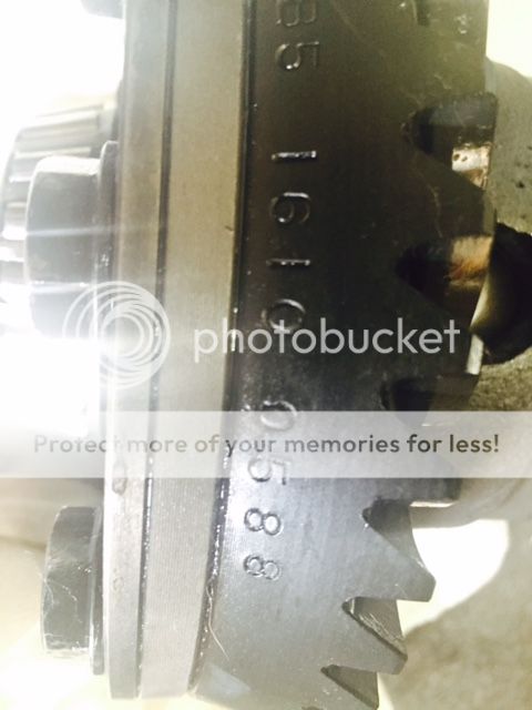

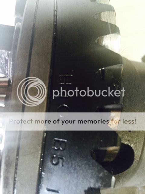

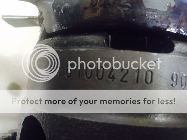

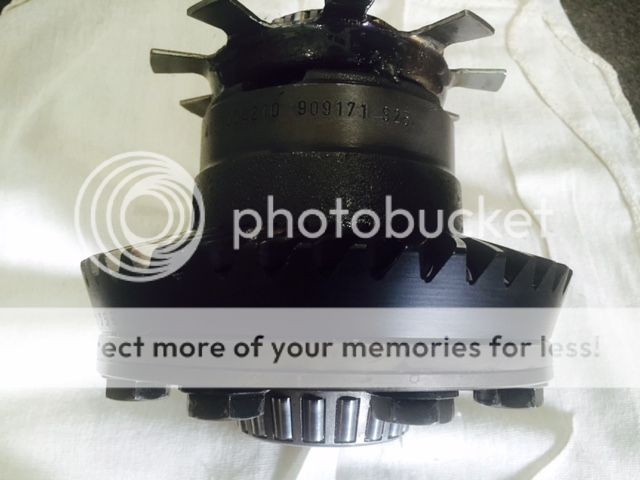

That's cool. Here are photos of my diff. I was just inside changing the pre-load. It seems the small belleville washers were inserted back to front. The cup facing the axle rather than the inside. Hope you don't mind me posting here.
lambertius
  • -Receive: 25
  • Posts: 182
  • Freshly Registered!
Re: M42/M44 ITB Kit Design
« Reply #326 on: June 24, 2016, 06:31:29 AM »
Wow! That diff is completely different to anything else I've seen! I wouldn't be surprised if that is an aftermarket cap as well though...
The belleville washer should face out towards the wheel - so it sounds like it was in correctly. I found this guide today on the small case LSD which is probably the best pictures on our LSD specifically http://www.bmw2002faq.com/articles.html/technical-articles/engine-and-drivetrain/strongest-2002-limited-slip-differential-build-r74/?tab=comments
How are you intending to adjust the pre-load? These OEM diffs are self-adjusting so you shouldn't be able to unless you replace the clutches...

« Reply #327 on: June 25, 2016, 04:21:58 PM »
I'm not convinced that I have the wrong way around, as the diff has been opened at least twice (once for a full brand new parts rebuild and once by the shop that put the guts into my E36 Coupe housing) between the original factory assembly and my latest messing about. That article does not specifically state which way the washer goes, only to be certain you put it back in the same way it came out.

« Reply #328 on: June 25, 2016, 07:38:04 PM »
This is a medium case rebuild, but when I dismantled mine my washers were facing the same way.

« Reply #329 on: June 25, 2016, 11:57:20 PM »
http://buildraceparty.com/diy-tech-how-to-rebuild-a-bmw-e30-differential/
That's precisely what I mean. In this article, the author states: " The concave side of this and bigger bellevue washers face the spider gears."
I have now disassembled 3 of the small case diffs, and the large belleville washers in all 3 show wear patterns consistent with the small bellevilles being placed with the concave side facing the large belleville or the center of the diff.
The pre-load is adjusted by adding/removing spacers/shims to alter the pre-tightened gap between the LSD cover and housing. Before I opened the LSD, I had 28ft/lbs of pre-load - the force required to turn an unladen wheel when the other wheel is on the ground and the trans is in neutral. Now with the pre-load altered (an extra small belleville washer and the other 2 washers reversed), I have 87.5ft/lbs of pre-load. I'm told the OEM spec is 60ft/lbs.
