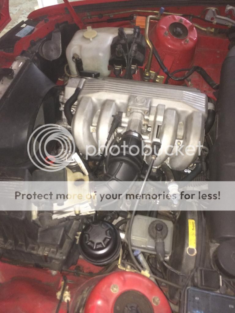

Did the 'Mess under the intake' mod this past weekend. It took about 4 hours from start to finish and I didn't have any unexpected issues that would have held things up. This was the main circuit that got removed along with the throttle heater plate:
The multi junction hose on the left was the major culprit for vacuum leaks:
After everything got buttoned up it fired right up. Much to my dismay my idle is still rough. It's better than it was, but still not right. I'm thinking injectors, O2 sensor, AFM. A friend brought me an 02 sensor and AFM from a parts car. I got the chance to try the AFM today with no change. I'll try the O2 Sensor tomorrow and change plugs afterwards to see what happens.
I've got a set of 19# mustang injectors too. They've been sitting for over 2 years, so I need to have them sent off to be cleaned before swap. My injectors were pretty nasty when I pulled the intake, so hopefully the swap will really show a lot of benefit. The picture below was taken after i did a little cleaning.
Hopefully it'll be running well shortly. I've got some cosmetic mods to do after - maplight rearview mirror, epsilloid headlights, 2nd light in the trunk (need to find some LED's for those too.

Would like to see some after pictures of your solution to 'mess under the intake'.
Your old injectors don't look too bad but the 4-hole injectors are a nice upgrade.
Second trunk light is great... if you wire them in parallel and not series. ;D
Doesn't look like much honestly. Throttle body looks a little bit tidier. You can see the breather hose on the left goes to the intake boot and you can kind of see that the hose from the ICV valve goes to the intake itself. Those are the most obvious changes. I didn't take any other photos because I was in a hurry to get everything back together. The "simon's take on mess under the intake" has some great pictures of what things look like under the top intake manifold.
Had about half an hour to work on the car today. Went to autozone and bought some NGK plugs and borrowed the O2 sensor socket set. Unfortunately the O2 sensor from the parts car didn't want to budge, and the metal siding was cracked and flared near the end anyway. It actually prevented me from getting the socket in place- had to use a hammer. I still plan to change out the sensor, or at least test my current one. The car drives great, only problem is at idle. Since it's livable i'm going to put off dropping another 150 bucks into the car since I'm still mid restoration on my 1600-2.
I did install the plugs though. Love how easy it is on this car. Old plugs were showing some age, but had uniform wear and were probably fine.
Installed new NGK's. Idle seems a tiny bet better - doesn't search as much but is still pretty lumpy. Not sure if that's the truth or just placebo effect.

I was just curious to see what parts you used. I did this last year and also deleted the heater core bypass valve. I found some coolant residue on the carpet so I might look into installing a simple bypass using 1/4 inch hose and T fittings, that shouldn't effect heat too much.
Might be mistaken but I think you mixed up two of the hoses. To my knowledge the valve cover goes to the throttle body and ICV goes to the intake boot.
Aside from that it looks like a good job.
