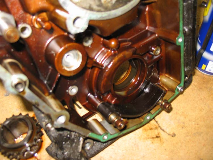

i still have problem to remove the crankshaft bolt, but i removed the head cover and the upper timin chase , the chain looks fine and the two big sprocket has no damage at all, but i couldn't remove the big crank 22'' bolt, so i didn't see what's behind the lower timing chase.
it's might be better to go to a truck shop and get some serious strong stuff to unbolt that bolt.
if any ideas on removing this bolt, just let me know please.
here is a pictures, this how i end up:(
[SIGPIC][/SIGPIC] I\'m in Europe, just let me know if you need to send something from here...

I've never taken that bolt off and hope I don't have to but I've read that you put the hand brake on nice and tight and use a breaker bar with a pipe slid over the end for leverage and it will come free .

you would have to have it in gear was well, then it will keep the car from turning over. then put a massive breaker bar on it, unless you have air and a nice big impact gun.

Never use a torque wrench to loosen a bolt.
You probably destroyed the torque setting so snapping off the front was no loss).
Go buy a cheap 1/2in breaker bar ($20) and put a length of pipe on it for leverage.

thanks for the info, yes the trouqe wrench was broken allready:) that's why i didnt care to much about it, tomorrow i ll buy a 3/4 thing so hopefuly it wont break...

Use the starter method. Let your starter loosen the bolt for you. As for having it in gear, you might slip your clutch even with a nice breaker bar as the bolt is tightened above what the stock clutch can grab.

but its going to have to first overcome the compression of the engine paired with the grab of the clutch, which i would imagine SHOULD keep it there...? the starter method sounds pretty good to me tho.
