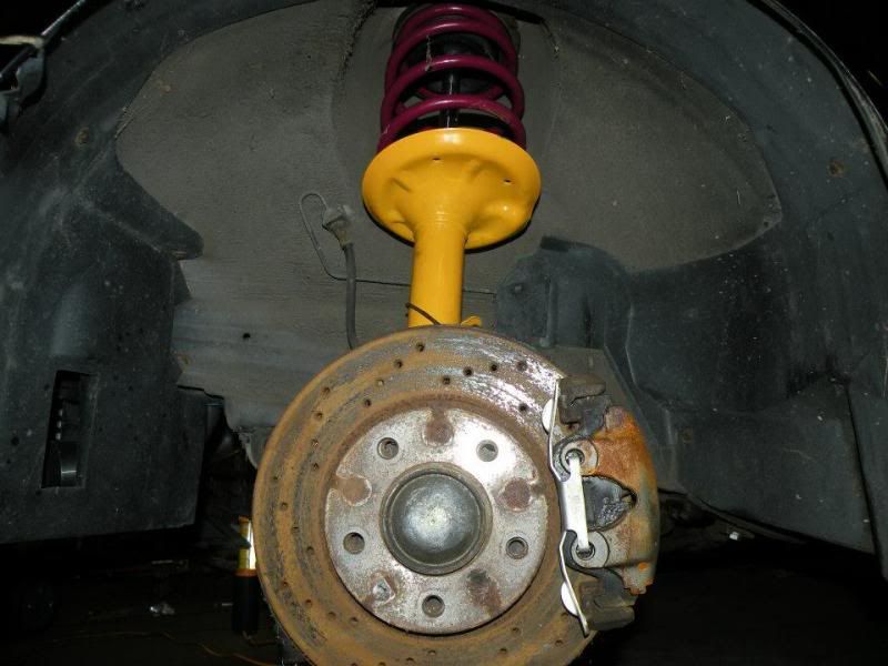

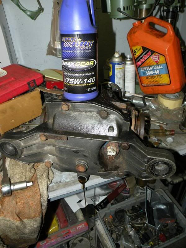

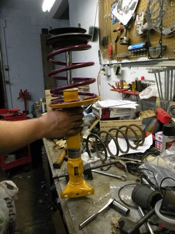

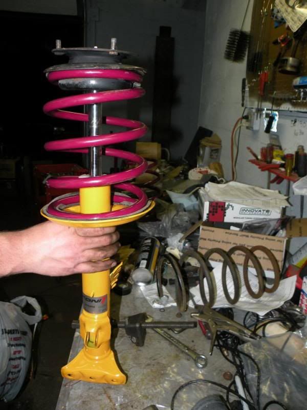

Here's the Fuel System and Suspension UpGrades!!!
Fuel System:
Suspension: Voghland Springs & Bilstein Shocks & Struts:
