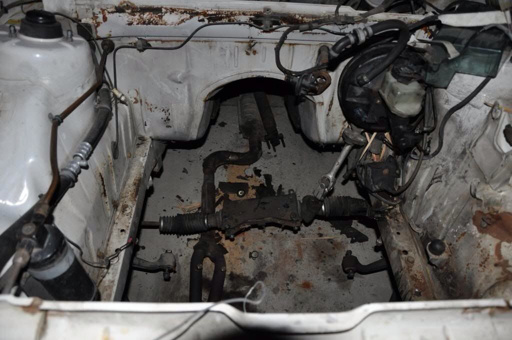

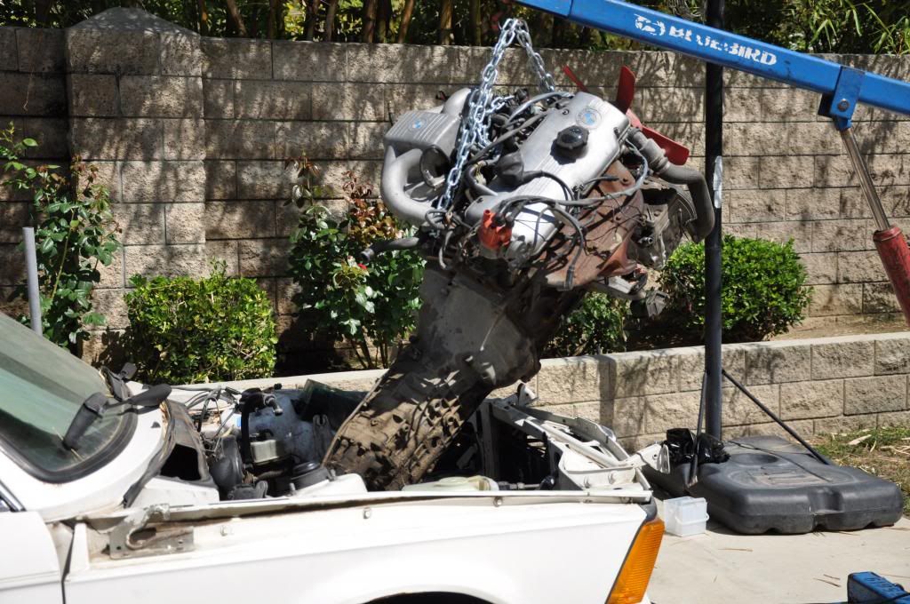

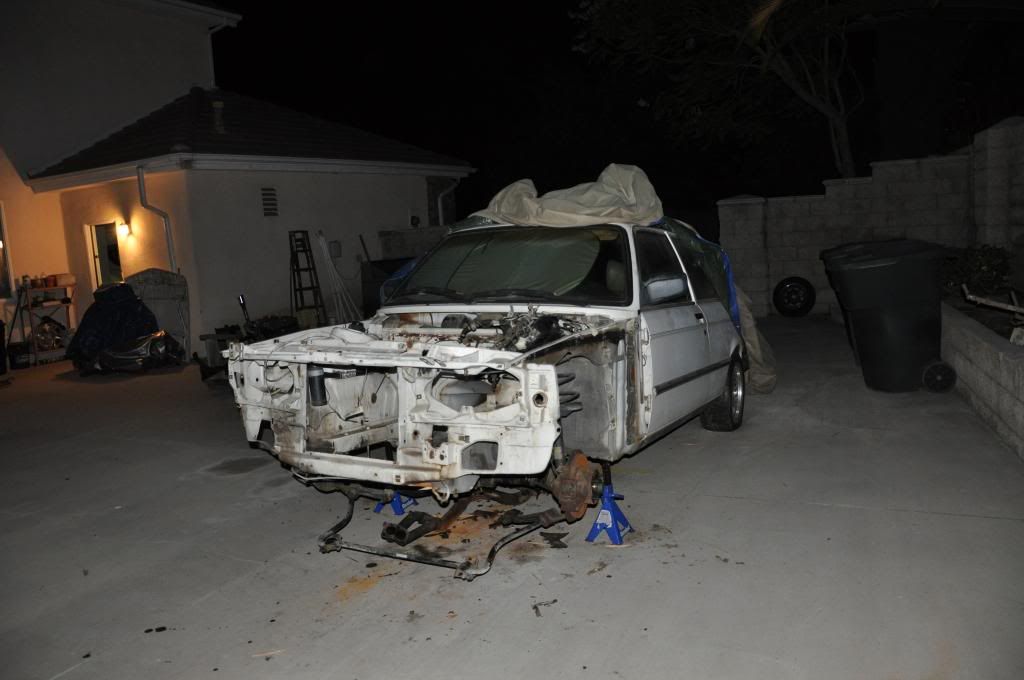

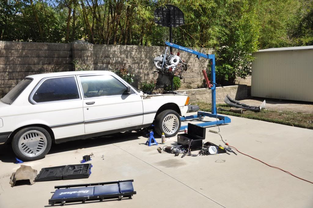

No major updates, but I took the M10B18 out of the e21. Need to prep the engine bay and modify the subframe so that the M42 can be slipped right in.
Hopefully this weekend I can get some time to see how notoroiously destroyed the timing compenents are, if they are that is. I have a feeling the previous owner didnt upgrade these parts.

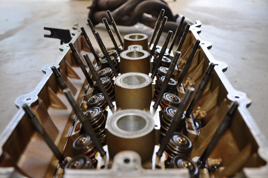

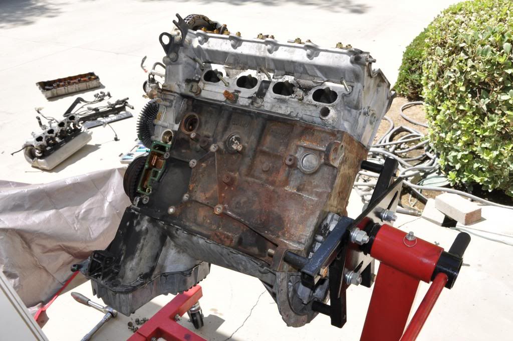

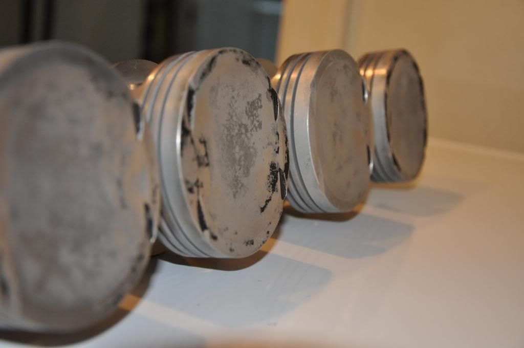

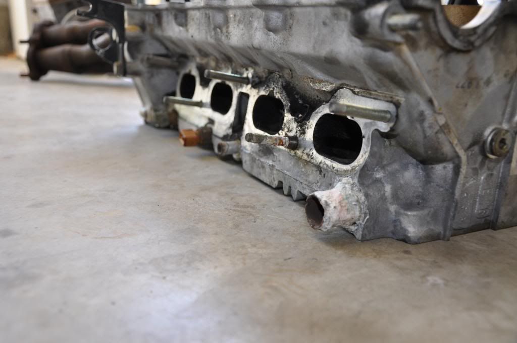

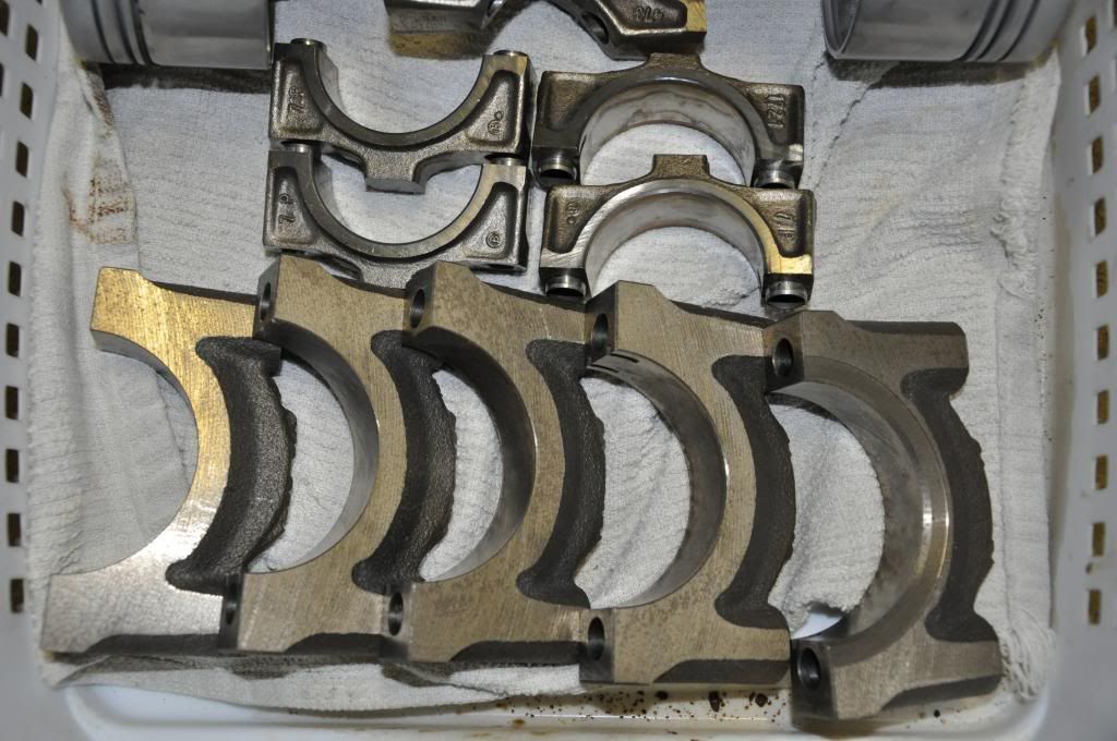

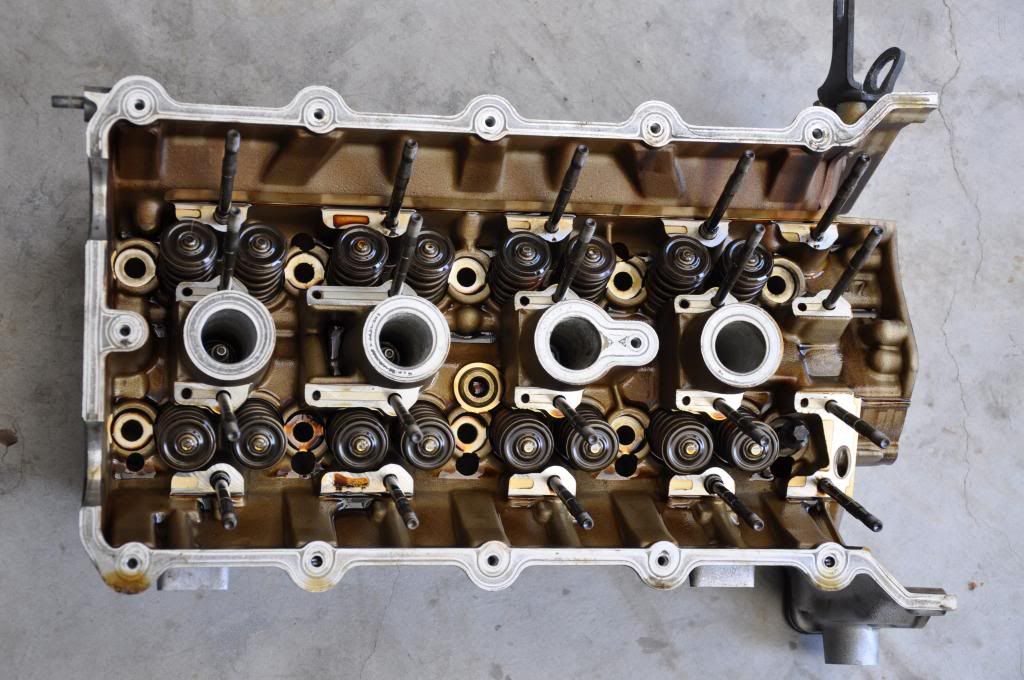

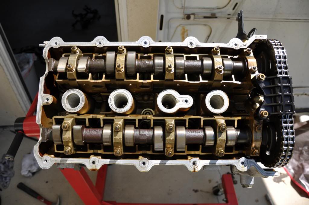

Got a chance to breakdown the important part of this build, the almighty M42B18;

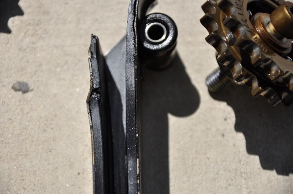

Slightly damaged timing chain rail (driver's side), definitely replacing it;

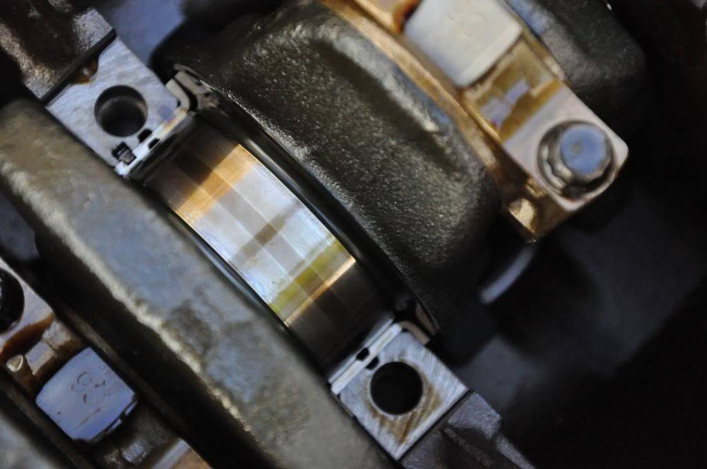

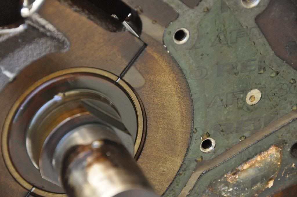

I'm not sure if a 360* main thrust bearing upgrade was done, it looks like it, but not certain yet.

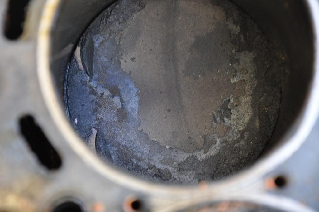

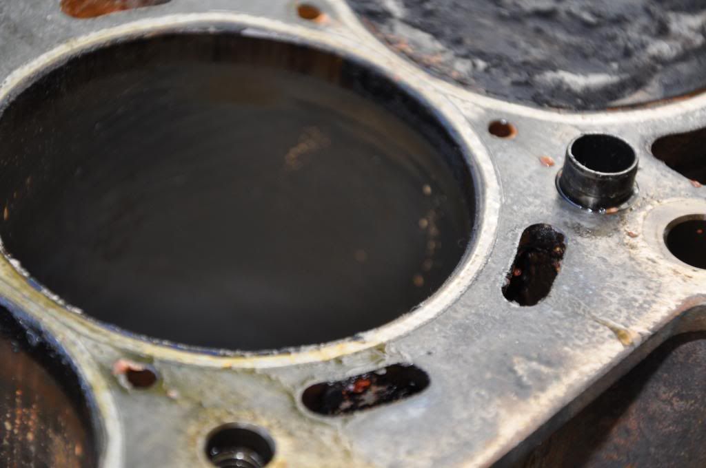

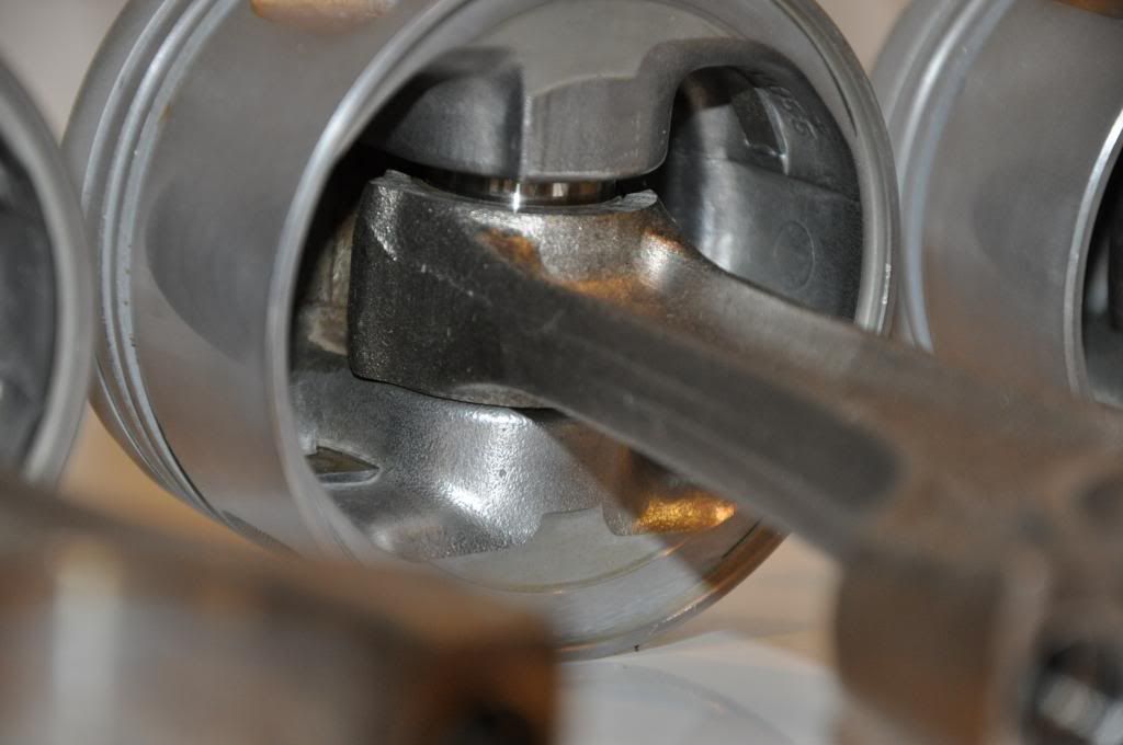

Dirty pistons. Going to clean them up to see if there is any damage, doesn't seem like it, but only time will tell (next week to be exact)
Cylinders seem to be fine. No "scaring" from what i can see.

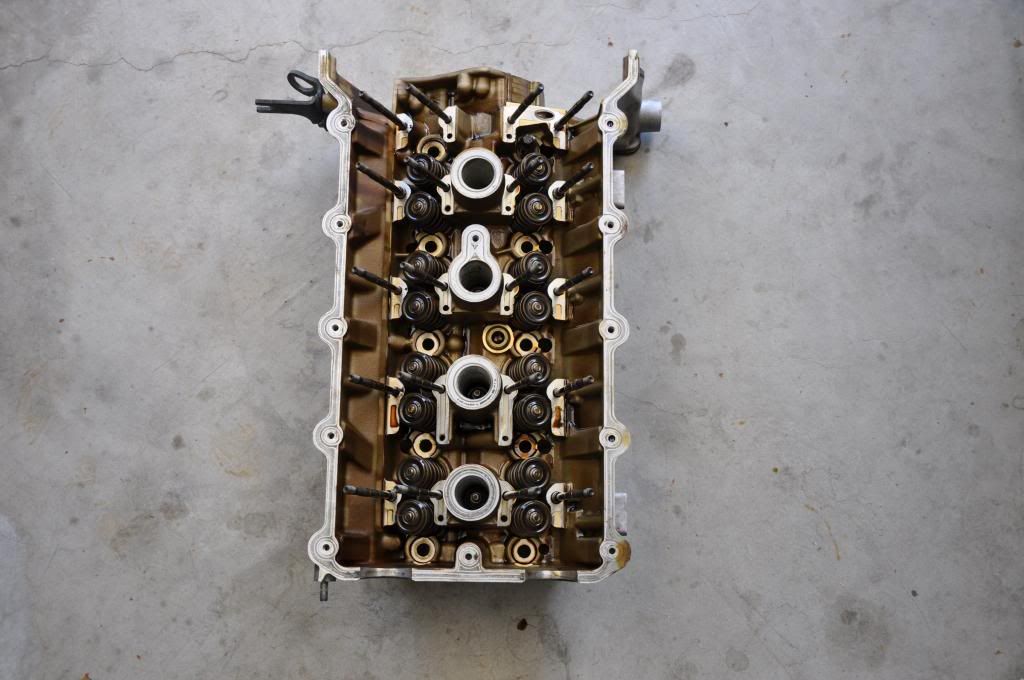

The head also seems fine, I am going to take it to a local machine shop for a professional inspection.

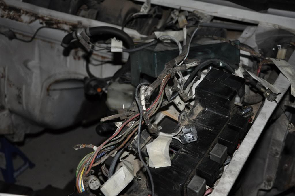

Should have more updates soon, but here are pics of my other mission; engine bay clean up and wire harness 'retape'

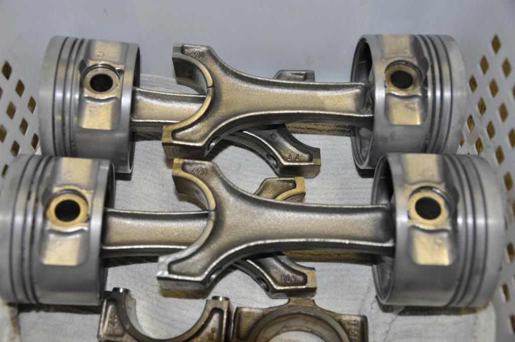

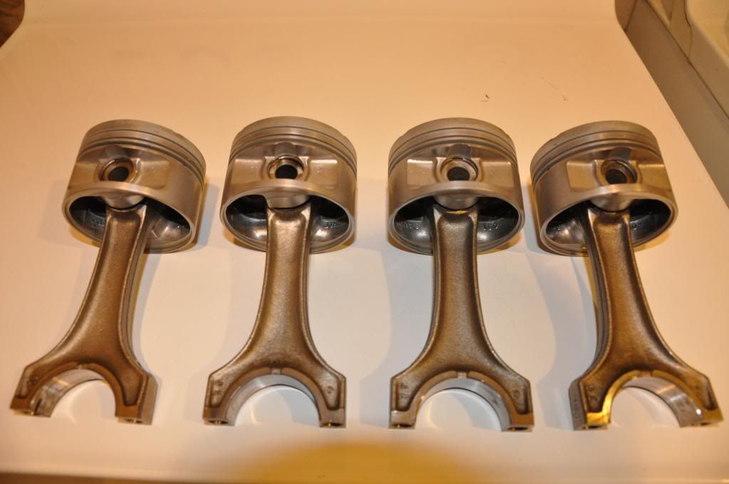

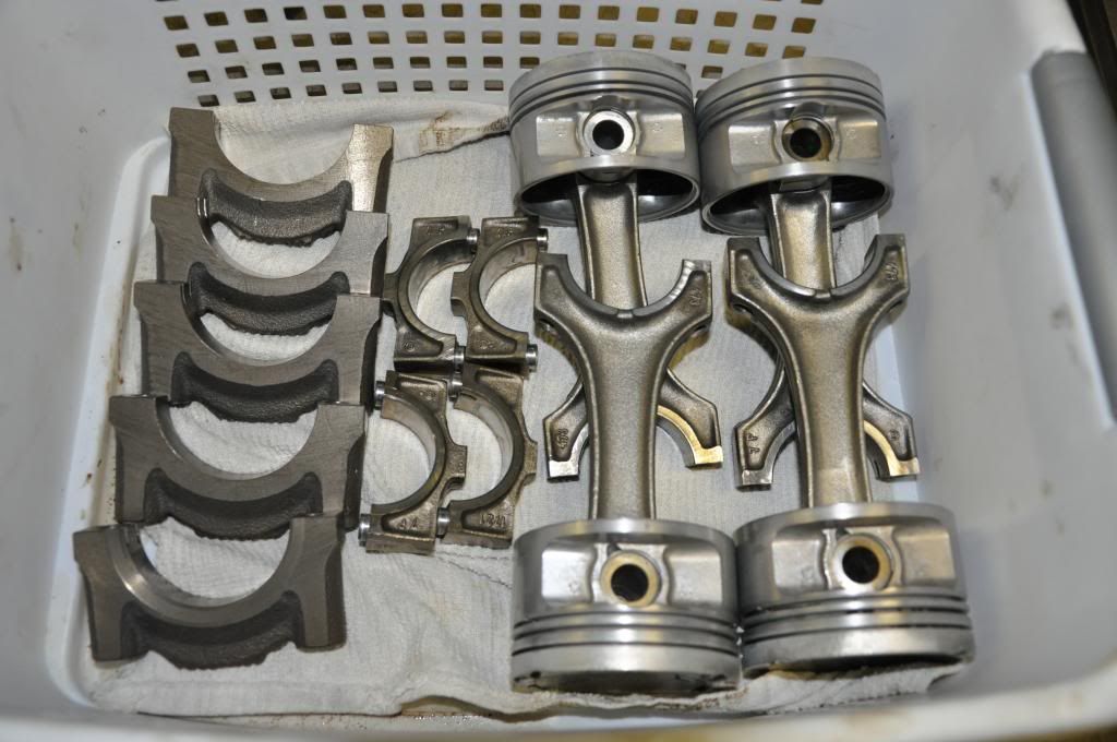

Since budget is limited to what I can sneak out without the wife knowing and being that forged pistons were definitely a no-go, i took some time to clean up the piston components. As you may notice from the previous pics above, there was heavy carbon buildup. The pistons were almost black in color....well, after hours in Chem-Dip, we have this;
I think this is as far as i will go with the carbon buildup.
So clean!
I'm going to end up using these components, but I will definitely be upgrading the thrust and rod bearings. Next update i hope to have nice head job story for you   ;)  :P

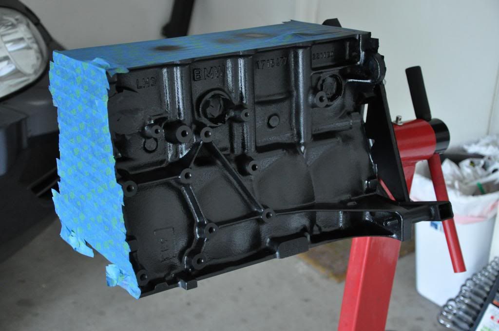

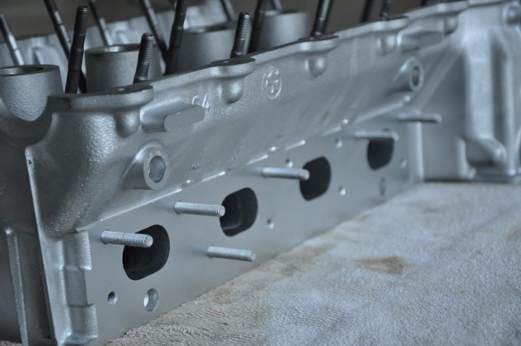

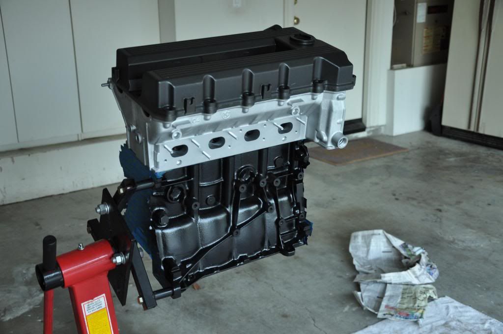

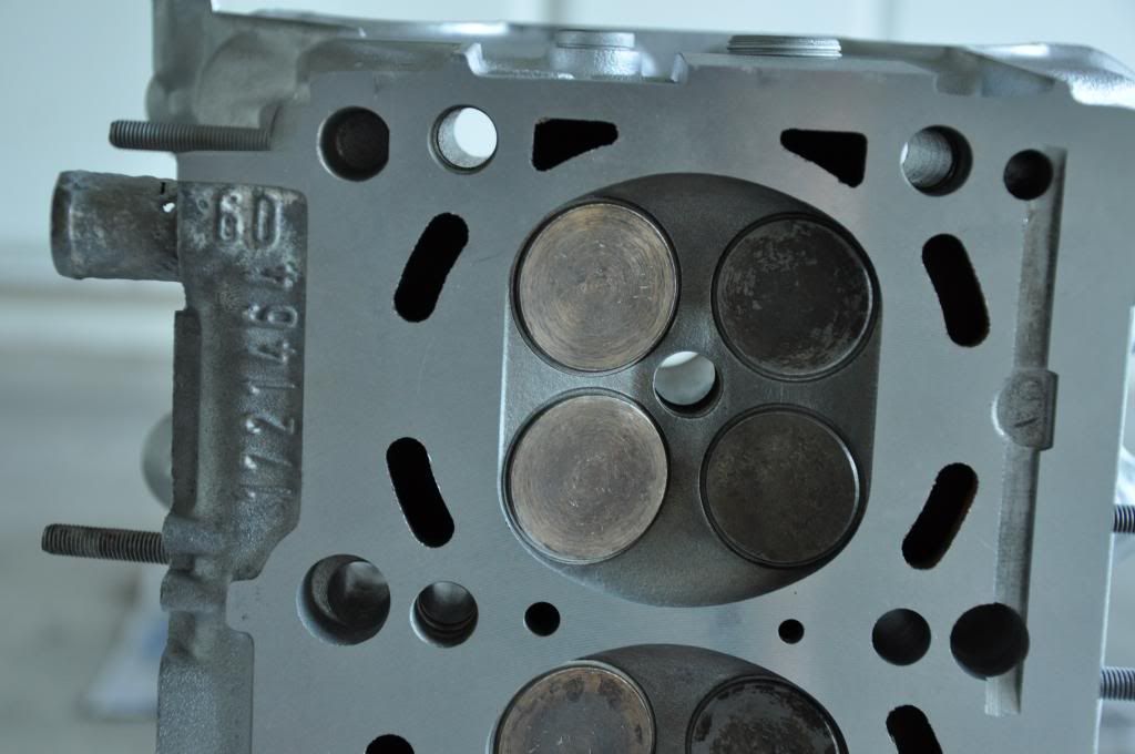

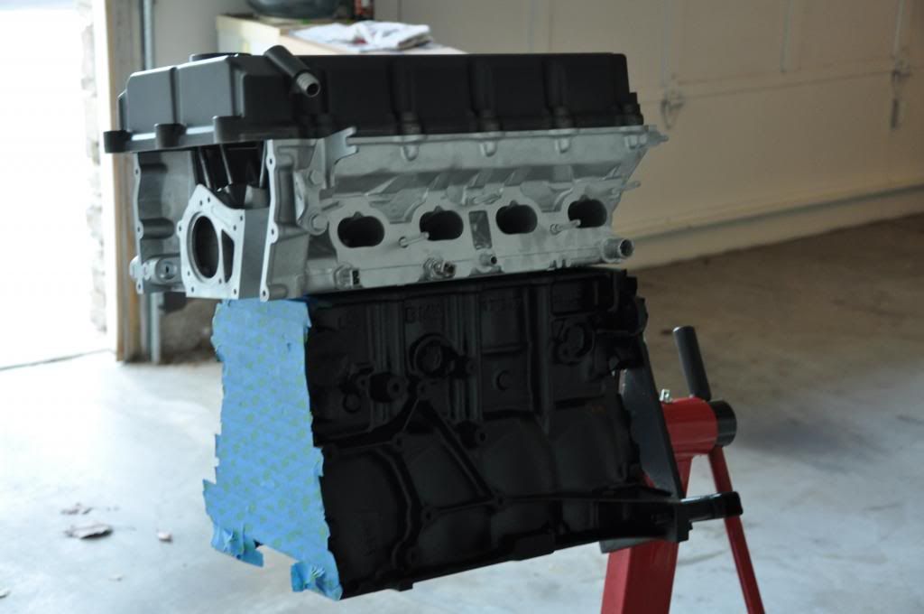

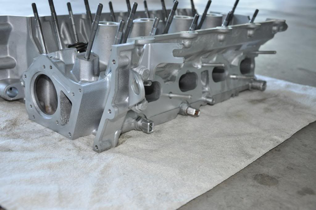

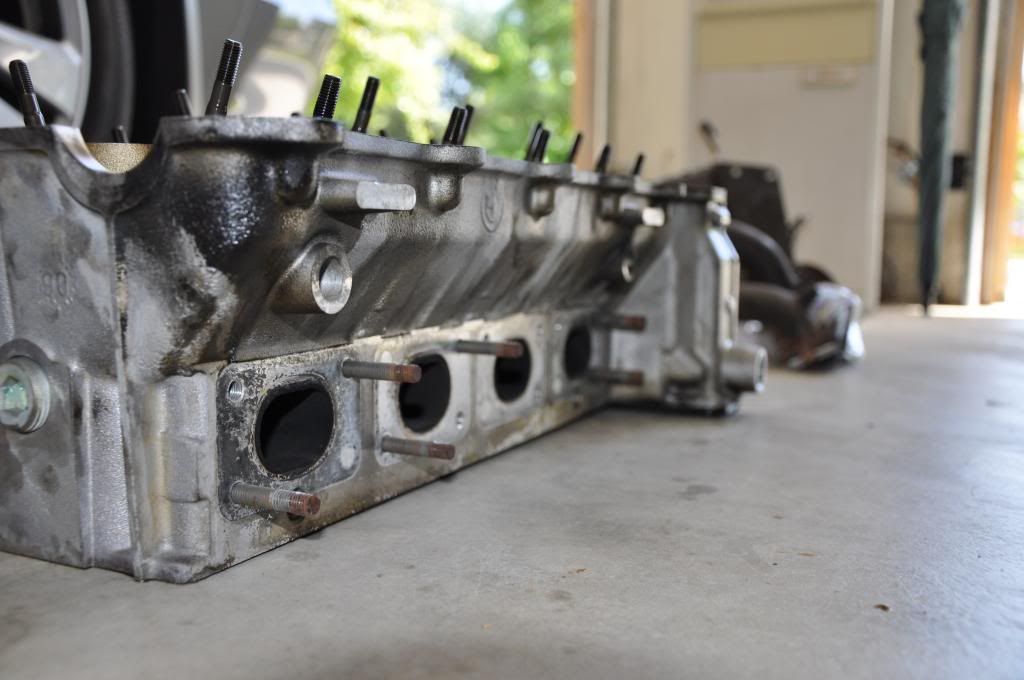

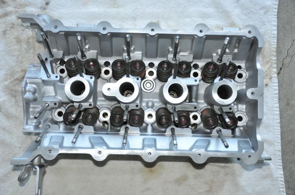

Took the head for resurfacing, valve job, and pressure test.
Also block sanded the engine block, cleaned it up, flushed the water jackets, and painted it.
Here's a mock up;
Have a few more parts to get; ARP head bolts, driver side timing rail, lower timing rail, M50 main thrust bearings, rod bearings, water pump with metal impeller, updated oil pressure relief valve, lower gasket kit, throttle cable bracket, cooling/vacuum hoses (mess under the intake) and whole lot of hardware.
Timing cases (upper/lower), engine mounts, intake manifold, valve cover, oil filter housing, oil pans (upper/lower) have all been cleaned and painted. Timing case has been cleaned.

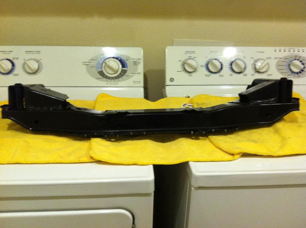

Keflaman, I wanted to respond to you so bad, but I wanted to have pics ready before I did. I'm terribly sorry for the delay in response.
Regarding your inquiry;

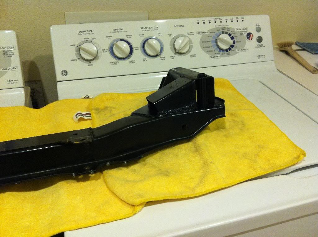

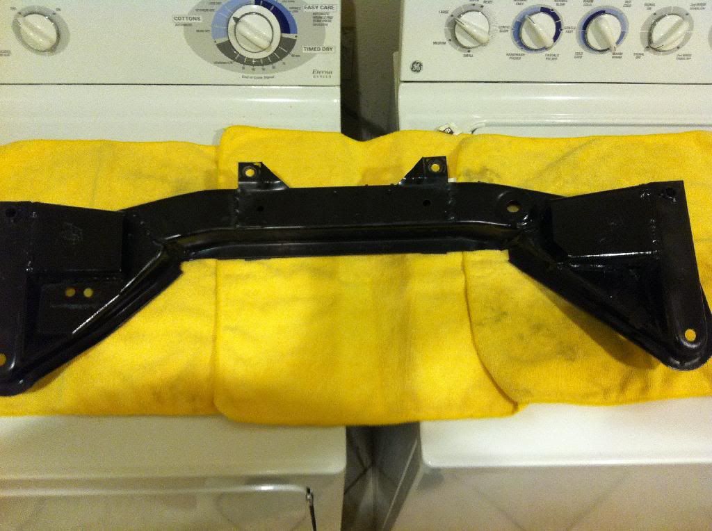

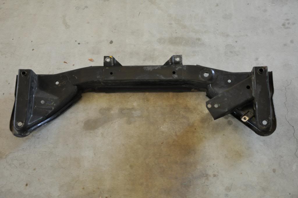

I needed to mod the e21 subframe, so I had to cut the 'horn' you see below;
I finally got a chance to go to my buddy's shop and weld on mounts;

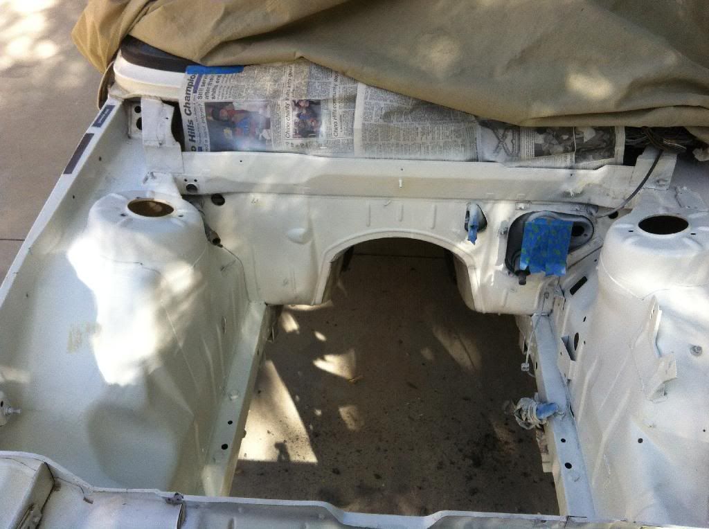

This project was suppose to be a track beater, but the engine refresh came out so good that i decided to clean up the engine bay so that the M42 would have a nice little home;
BEFORE;
AFTER;
Lots of Purple Power, scrubbing, sanding, and spray can primer. Was up from 10pm-3am that day.

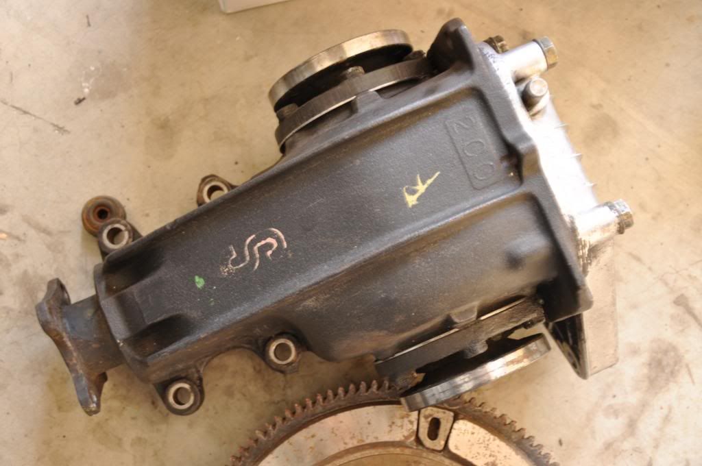

I will be getting a hold of a 3.91 LSD very soon. once i do i can complete my rear end. I'll be using the e30m42 driveshaft and getrag.

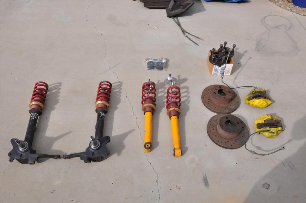

Got some parts this weekend that will help finish the build;

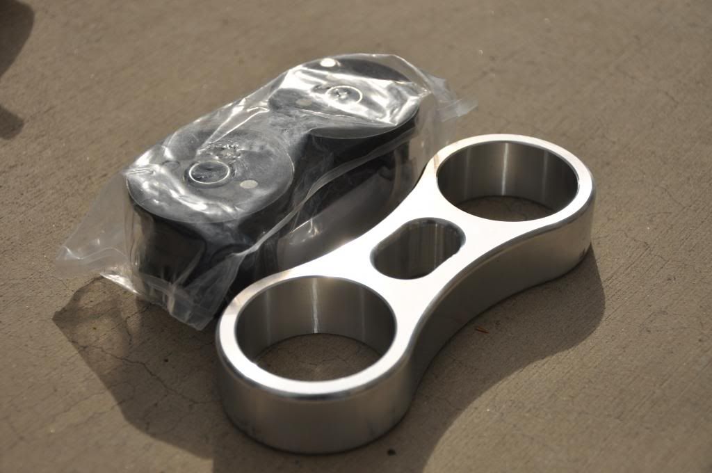

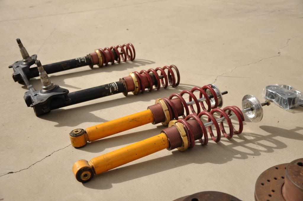

Custom Billet Aluminum Differential Hanger with Urethane Bushings. This will help the weak designed, metal stamped hanger that originally was used on the E21.
Ground Control Coilovers, Koni Sport Yellow shocks, and Eibach springs. Waiting for camber plates.

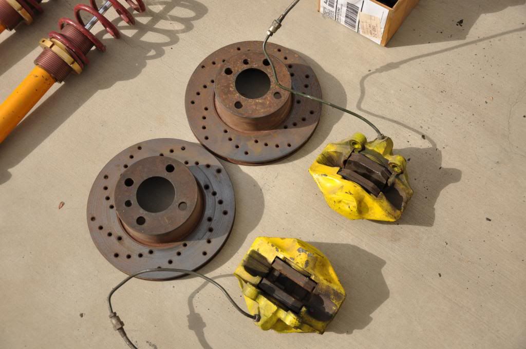

Euro 323i front calipers with vented, cross drilled rotors.
Also working on rear disc brake conversion. Using E21 323i rear trailing arms with E30 325i calipers and discs.
A 3.91:1 LSD will go great with the M42.

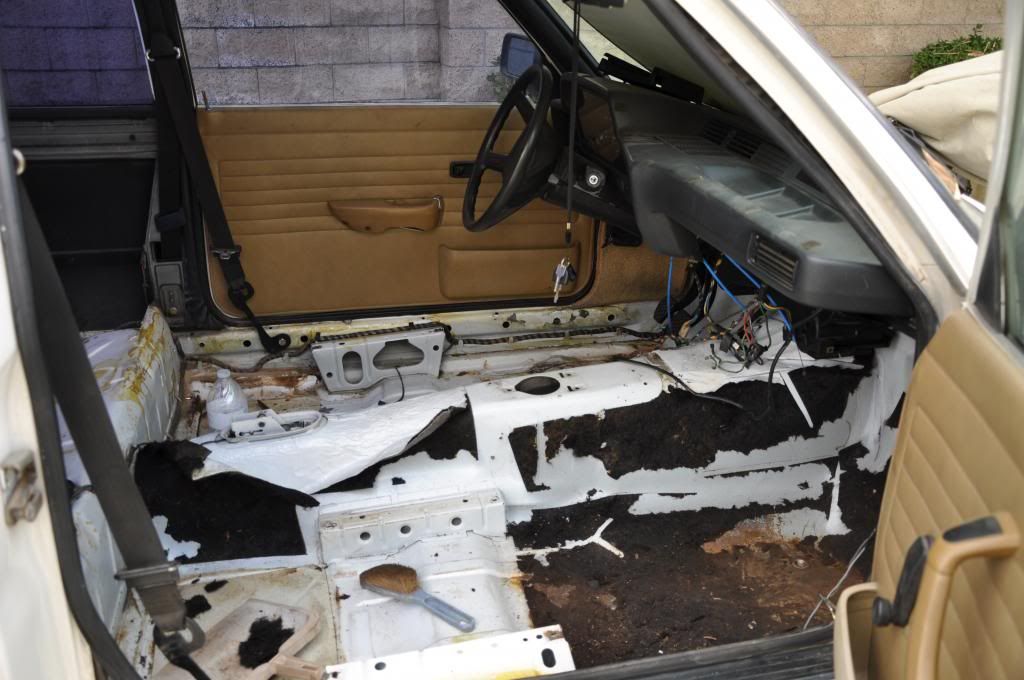

And with a multitude of projects, I'm also working on stripping the interior.
Next update, I should have the car put together.

Do it Dave!! I put the engine in last night. My hands were too dirty to take pics, but I got some in this afternoon.
I have a lot more work to do, but the biggest task is out the way.
