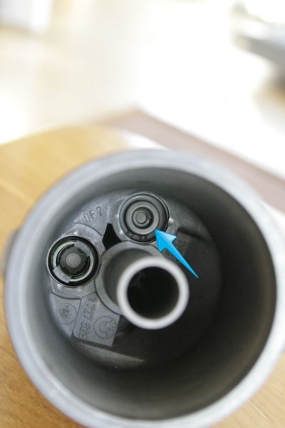

Okay, I'm probably just being paranoid but I thought I would ask.  On the oil filter housing, are the highlighted check valves able to be manually moved?  Do I need to check them or R&R them somehow?  Are they prone to failure?

There is one bypass valve and two check valves. Check valves prevent oil flowing out of the block and filter housing to the sump. Bypass valve opens when filter  differential pressure reaches limit set by BMW.  Such situation can happen during very cold weather engine start when oil viscosity is high. You should be able to  open them all if you will get access. The one which goes to the block as I remember is possible to remove from filter housing.

Should I be able to depress the center button on the check valves or do they push out (away from the block ).

I do not remember which but one of them you should be able to press and one  to pull.

romkasponka - thanks, you're exactly right.  The check valves highlighted by the blue arrows pull out, and quite easily I might add.  Of course I didn't think to pull before I pushed and I boogered them.  The bypass valve (the one not highlighted) pushes in.
So, add the price of a new filter housing to the cost of my education.  I'm tired of breaking perfectly good parts (cam tray and now filter housing) kind of feels like child abuse. :'(
