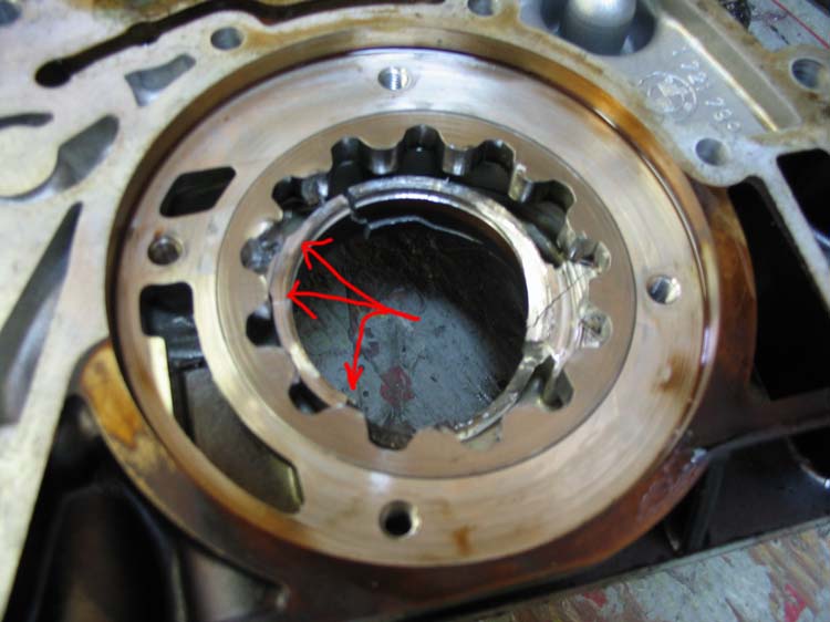

Quote from: tim_s;16651
When you say thatthe lower timing cae forms the front part of the oil pump itself, what do you mean? I've never dissassembled the lower timing case, but thought that the casing was simply a casing and the rotors, spring, valve etc were the important bits. Should I change it? I'm not too keen to have to get in there again, I'm pretty keen to resolve this in one hit but its a lot of money for a new casing.
The gears sit inside the timing housing and a cover place forms the back half.
If you have oil slipping through on the sides you will lose pressure just as if the gears themselves are worn. Given that the housing is aluminum, that is most likely the worn part anyhow.
This is the backside of the timing housing minus the gears.
With the outer ring gear

« Reply #31 on: January 04, 2007, 04:17:49 AM »
Thanks that's really useful. Makes a lot of sense. If I don't have time to pull things this weekend (I don't think I will), I'll order a new lower timing case next week.
