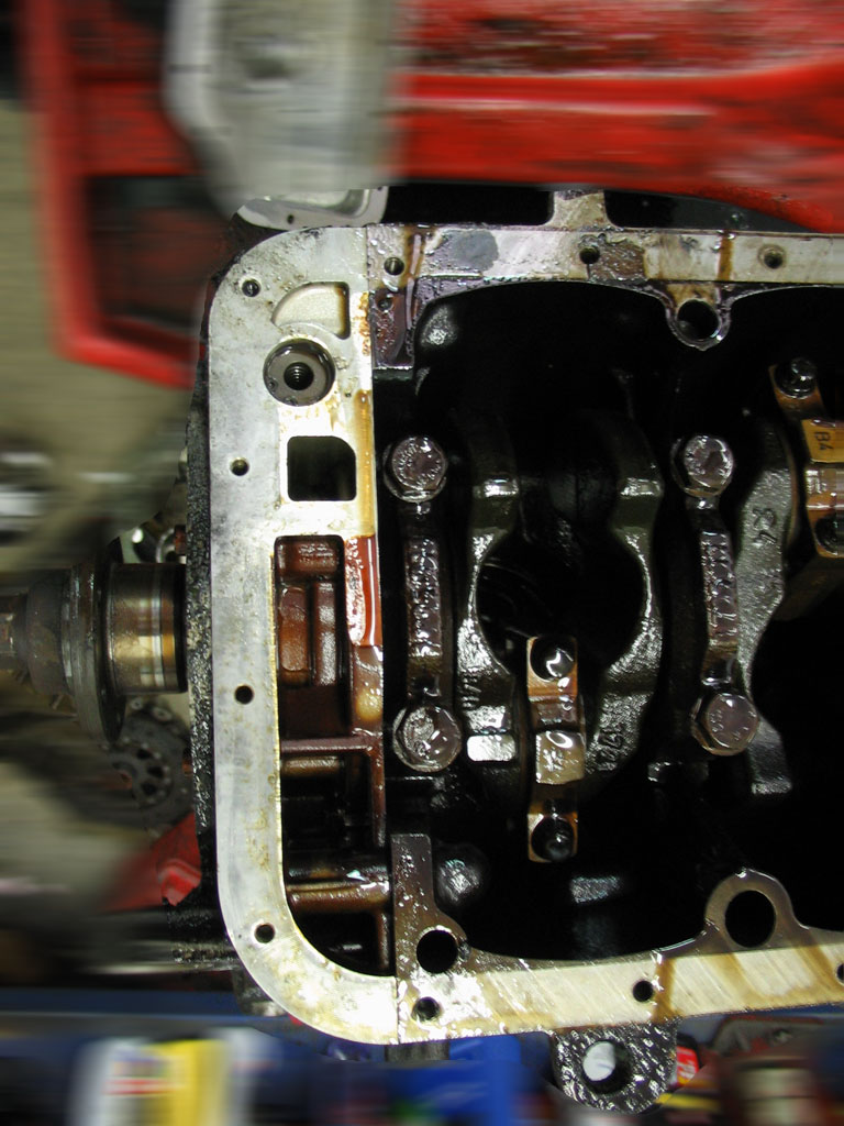

« Reply #24 on: December 31, 2006, 03:29:45 PM »
Quote from: tim_s;16481
yeah sorry sheepdog didn't make myself clear, i realise the lower pan has to come off to get the upper one off; what i really meant is is that all? Is the spring etc accessable from underneath with the upper pan out of the way or will i need to pull the lower timing case? Was tempted to try the spring before changing the whole lot, but am still undecided as to whether to go for the whole lot in one go.
You should be able to slide the upper pan to the side far enough by lifting the motor a bit and get to it.
You can see it here...
The clip is visible when the pan is off.
Here is what it looks like with the upper pan removed (looking up at it), the spring is in the hole at the upper left in this picture. Left side is the front of the motor obviously.
