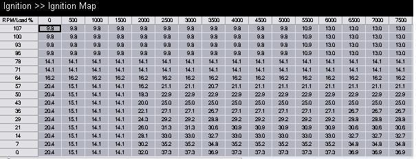

Alright,
since this is real easy, everybody has the same engine,
probably running similar sensor configs and so on,
This should make for good info for others wanting to go for standalones,
Also if anybody has the original maps they should of course be uploaded,
I´ll go first with my ign map,
How this works is ..............
The values in the ign maps (tps vs. rpm) are coupled together with the values in the amp (map sensor) table (wich in this case is in 0.15bar - 1.1bar absolute)
Example
RPM 2500 , throttle 31% , value is 32 , this will be 32 at 1bar pressure but will be 41 at 0.5bar pressure (32 + 9 = 41), I´m not using the iat yet but it´s the same there, you can take out or add ignition based on pressure and air temp
Those numbers probably don´t look anything like a MAF map, MAP map, TPS map, as it´s all relative to the system, but they do give an idea as what they should be, you obviously can´t be at 25% throttle with 1bar absolute ,
and so and so.
Gunni

Also in that picture the throttle range from 22% to 77% is the range from 0-5v my TPS puts out, i.e 1.1v-3.85v is the range my TPS works in, so there is no
misunderstanding.

This is the best image of the ignition map i could get.

is 107% load 20psi?
what is the load measuring device, map , afm , tps, or what

the load is Throttle Position 107% is WOT

there must be a another map that has something to do with manifold pressure?
as you can have 0-20psi at WOT
