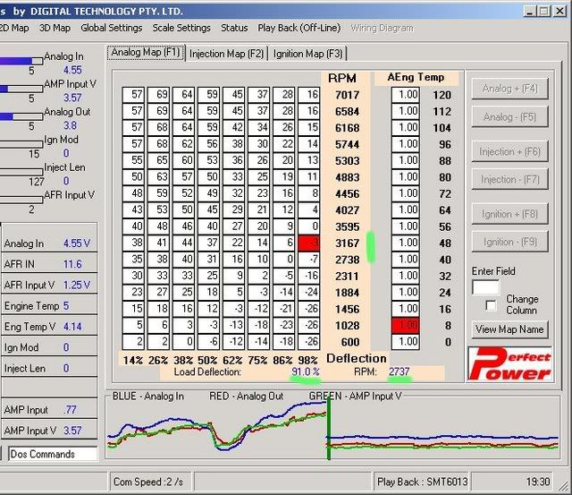

yeah, im not a big fan at the moment. Check this out:
Why does 91% deflection and 2737 rpm make the site in the red the active site? Surely it should be at 86% and 2738 rpm! I'm close to ripping the SMT6 out and buying another MS. The PP works very well for straightforward stuff - the timing control is good, and tuning AFM to optimum AFRs. i'm beginning to think i made a big mistake going for the MAP conversion, I think i was influenced by gunni's reports of good progress and various other conversions and thought it was a good idea. i'll keep tuning the voltage conversion map thing, and hopefully i can get it closer to mimicking the AFM and see how i go, but stuff like the above makes it near impossible to tune accurately.

Gunni
  • Posts: 277
M42 Engine management maps and info
« Reply #42 on: April 24, 2007, 05:33:00 PM »
what you are supposed to do is try and get as close as you can,
after that you can drive the car and re adjust,
Why those look like that I can´t tell,

« Reply #43 on: April 25, 2007, 03:29:11 AM »
yeah, i thought that was going to be the case, but I think it's going to be a bit more tricky than that. I got a lot of sites pretty good but then the transitions on the map aren't good. This causes an oscillation in the output signal that the motronic doesn't like. If I then smooth the map out its not as close to the orig output of the afm. If you look at the above the red is the PP output, the green the AFM output. As you can see the AFM output is much smoother, even though the blue (the MAP input) is pretty smooth. you can also see just how different the MAP output is from the AFM. I'm thinking MAF would be a lot easier.
Even stuff like idle isn't very good at the moment. I've only started working on it from the weekend, but it's not looking too promising. it's going to need a lot of time mapping it, and i think it will never be as good as the AFM. the car drives, but doesn't feel as good as motronic anywhere, whether in town or cruising.
As for why it keeps on choosing the wrong site, I'm completely at a loss. But it does it a lot!
Not impressed overall :(
Gunni, I can show you my logs and config etc if you're interested? How did your map and logs look when you converted to MAP?
