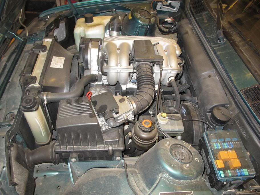

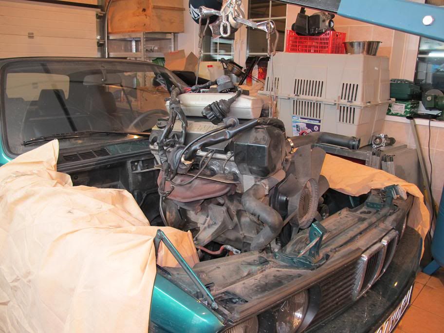

So...It is my car:
e30 318iC 1991, M40B18...:(
The m40 motor is pulled out...
« Last Edit: January 21, 2012, 01:41:58 PM by IFuad »

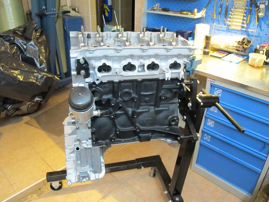

Has started motor reconstruction:
The motor with run of 75t miles, in good enough condition.

Clearing and painting...

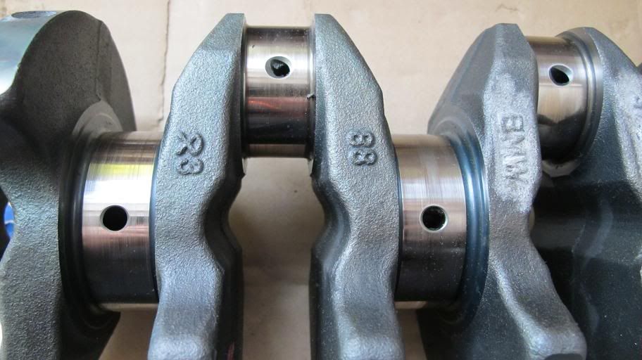

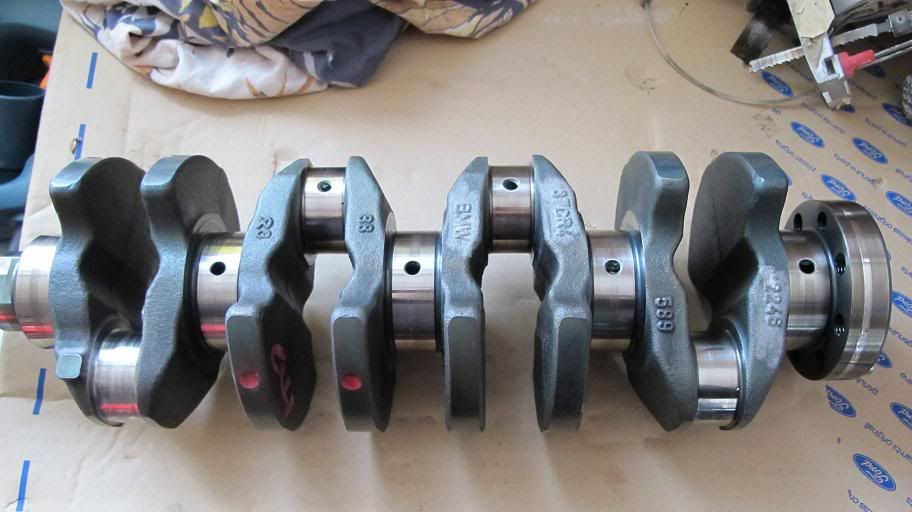

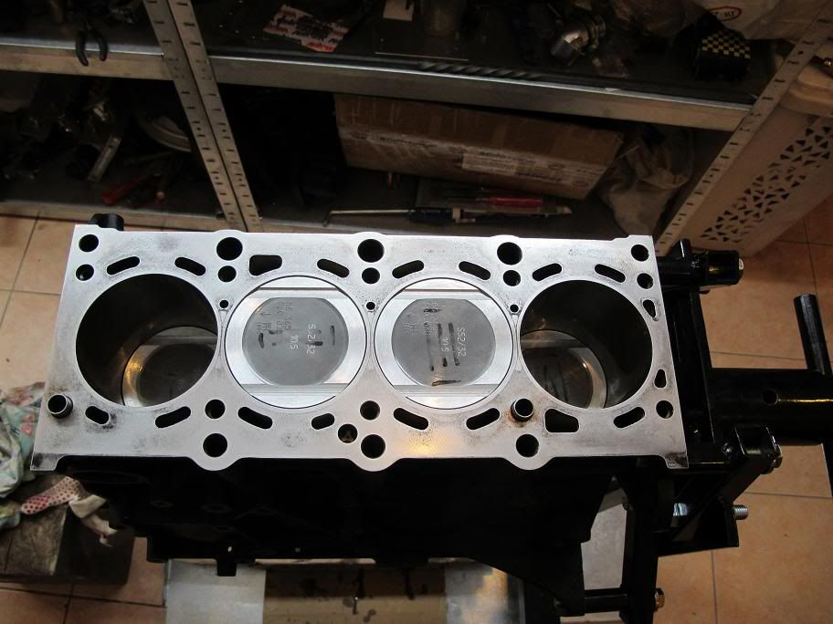

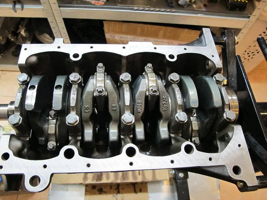

I buy used m47 crankshaft on the average condition.
Later the crankhaft reground in the first repair size (sorry,i do not know as will be in English)

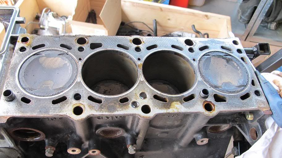

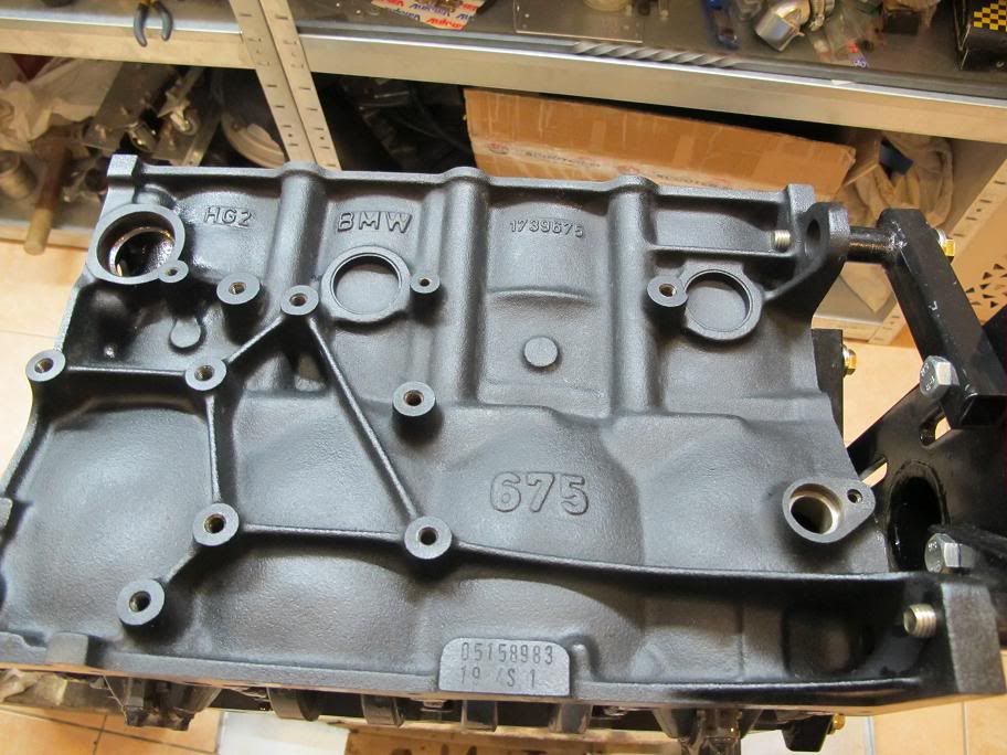

The cylinder block has painted
Crankshaft bearing from m47 engine
Rod bearing - m44 original
s52b32euro pistons shaved on 3.6mm. The place for valves is made: exhaust -1,2mm, int-1,6mm.
« Last Edit: January 23, 2012, 04:38:25 PM by IFuad »

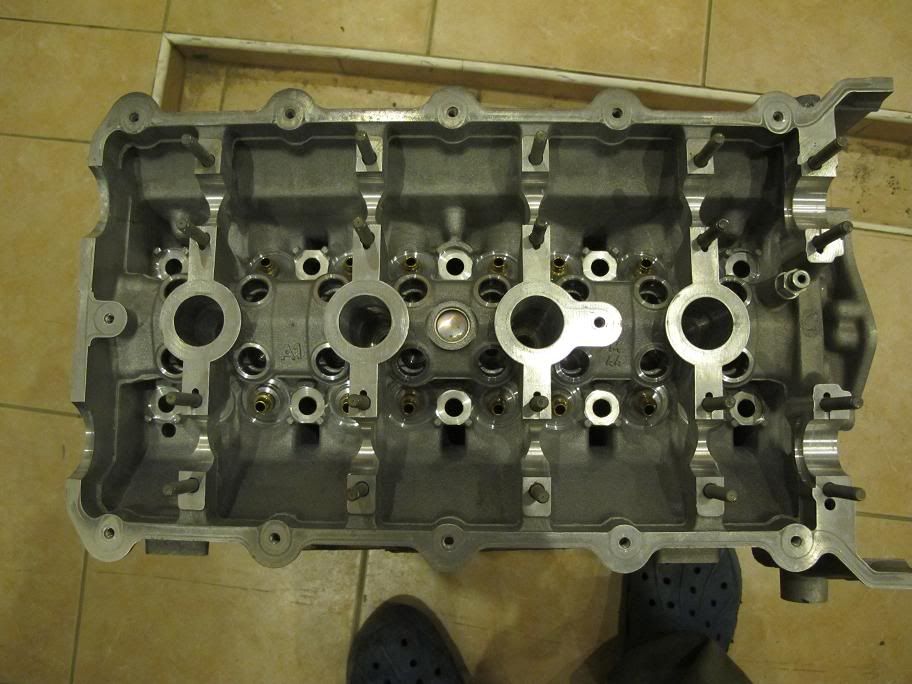

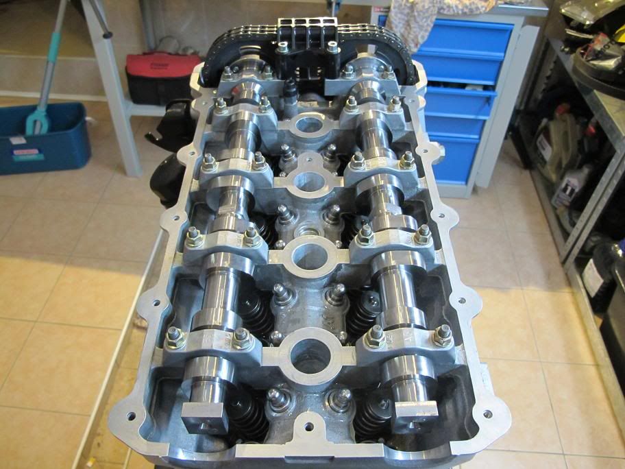

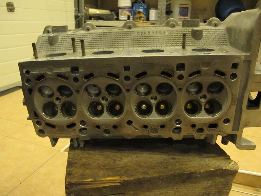

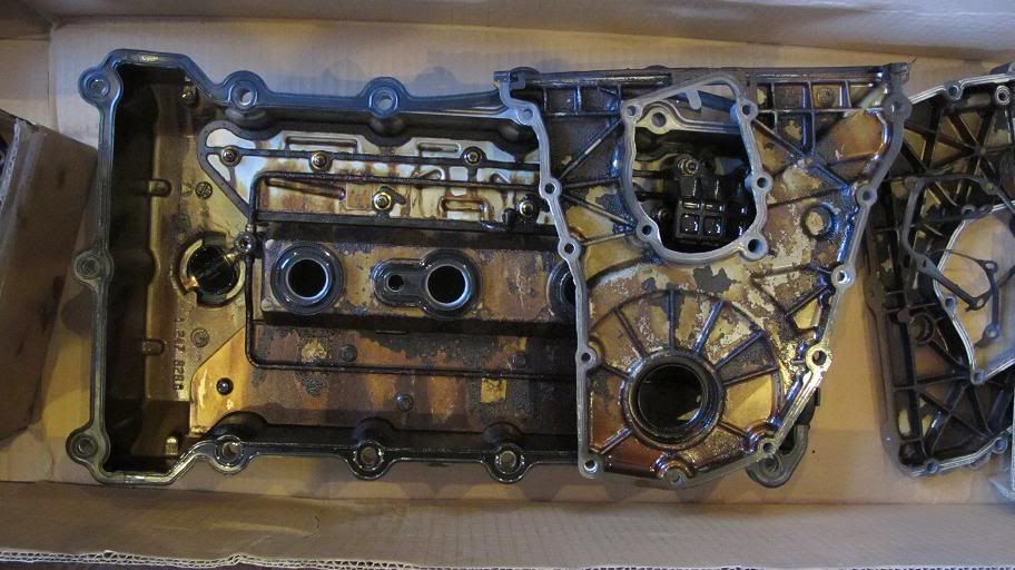

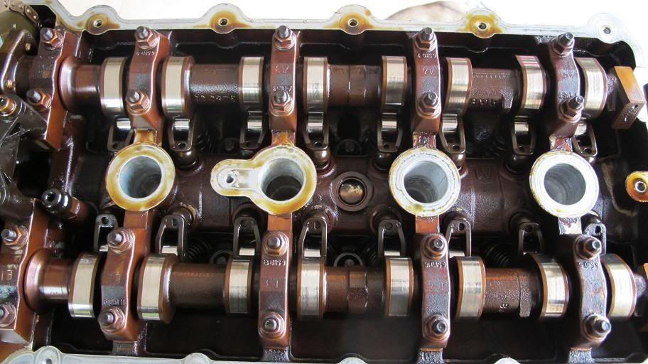

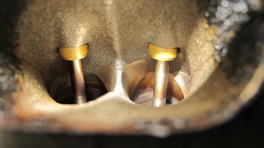

I continue... head cleaning
and installing

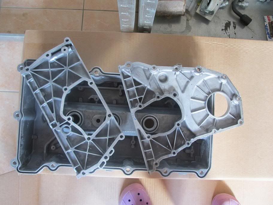

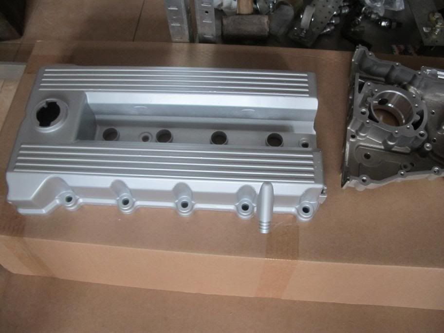

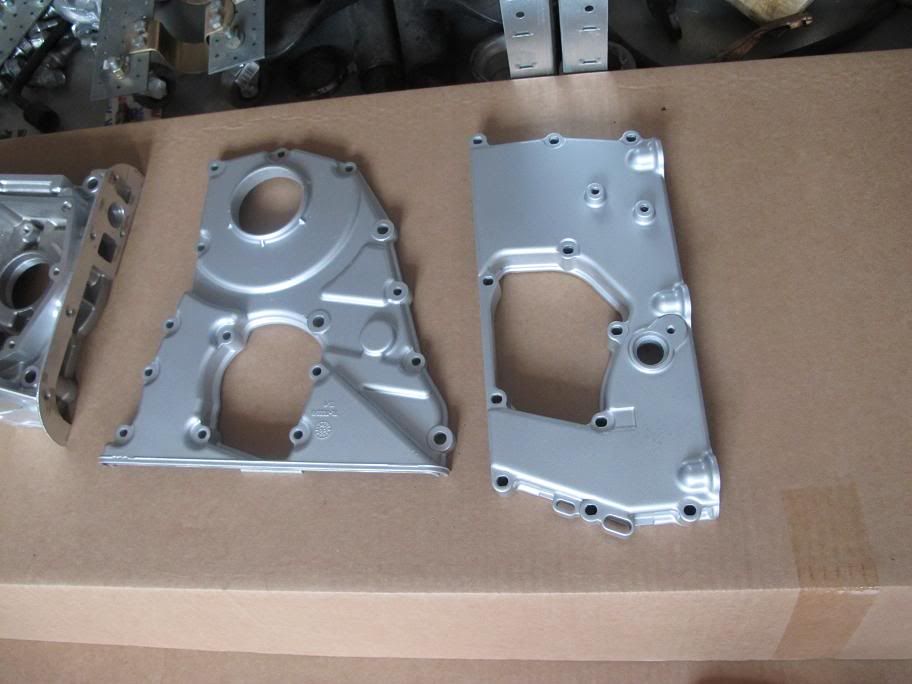

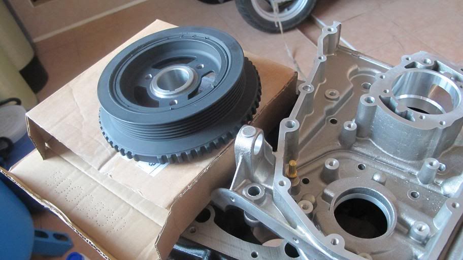

I buy front cover for the м42 motor, for the external crankshaft position sensor.(The crankshaft from the м47 has no touch sensor wheel).
M42 crankshaft pulley

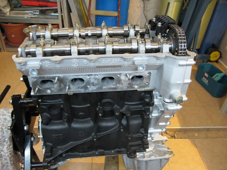

The parcel has arrived...
Camshafts, chain, sprockets are installed

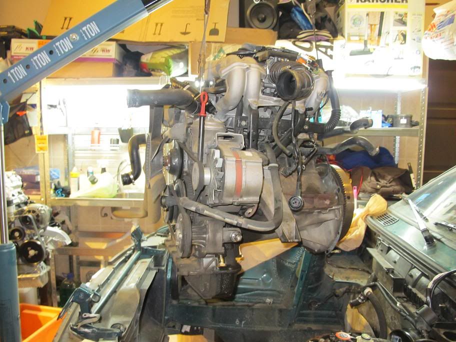

« Reply #9 on: March 09, 2012, 11:05:03 AM »
Continue my swap...

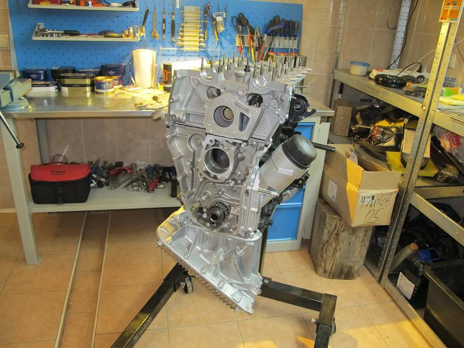

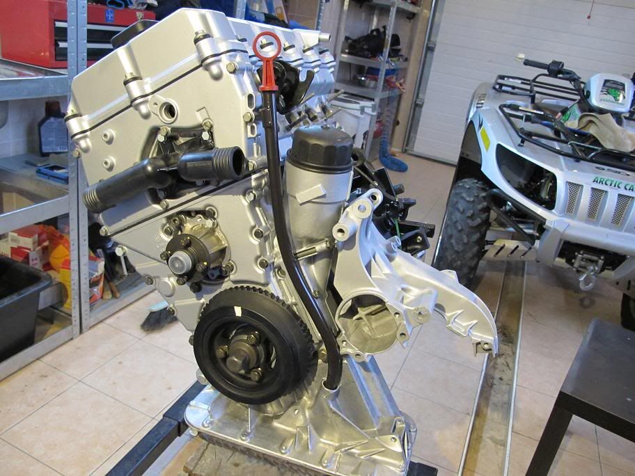

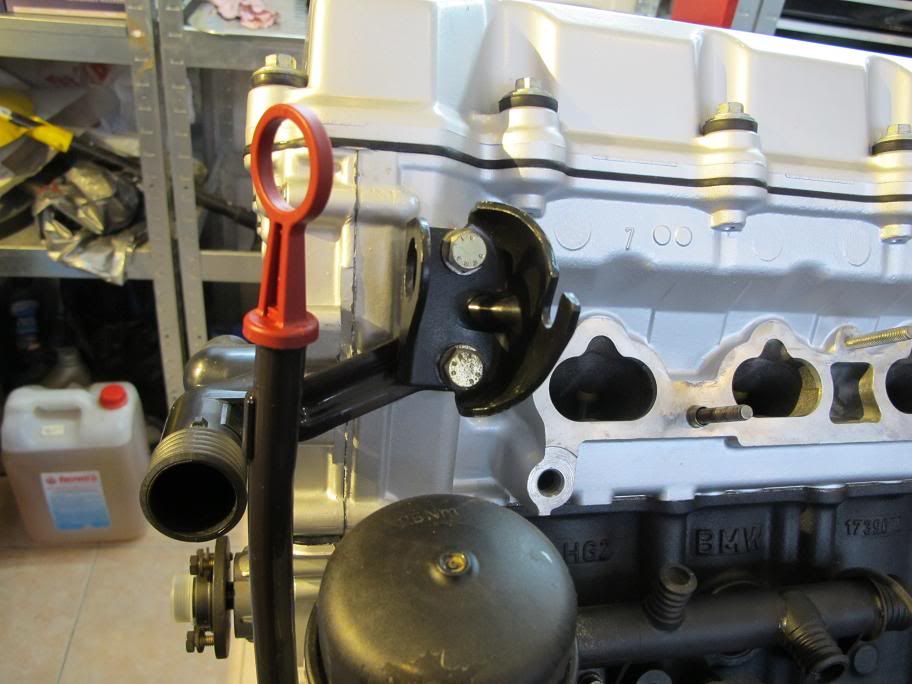

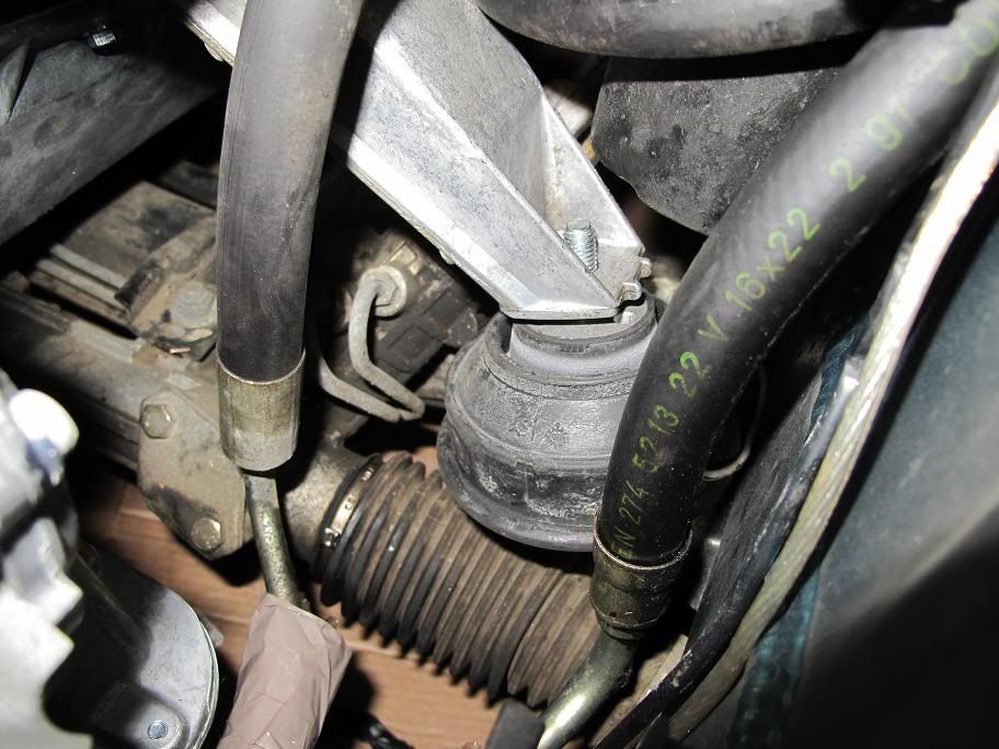

Oil level dipstick m44, it is a little corrected, painted and fastened
The motor has installed on stock m40 bracket, and e36 motor mounts (little changed - excentr.clampers deleted)

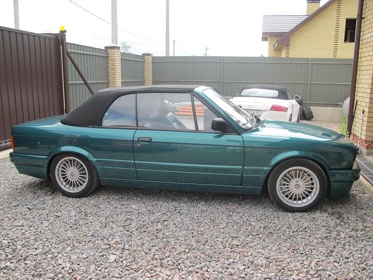

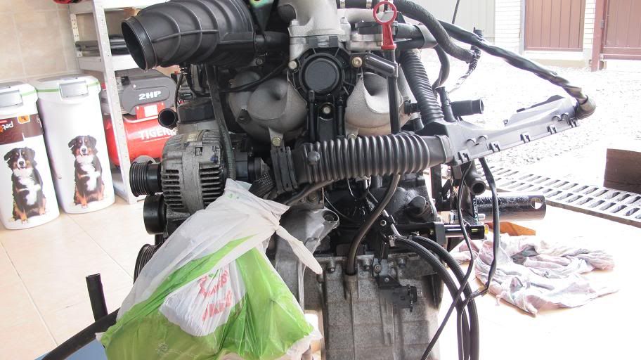

« Reply #10 on: March 08, 2013, 03:18:36 PM »
final result...

Final config my e30 cabrio:
m44 block
m44 stock head
m44 stock conrod
s52b32 piston 86.6mm (CR 11.5)
dbilas 272g camshaft

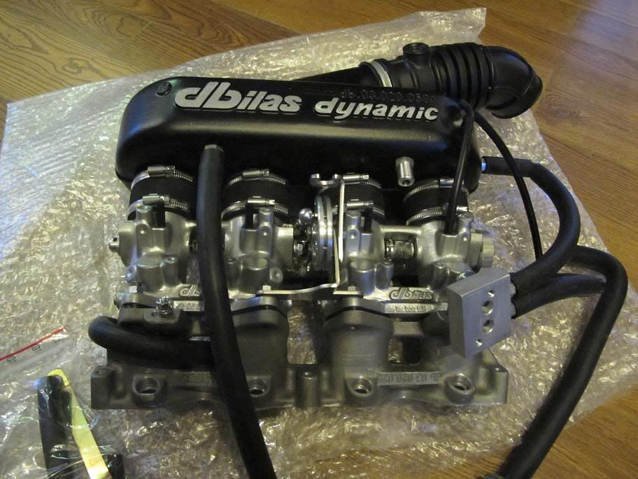

dbilas ITB
bosch 0280156070 injector 272cc (it isn't enough productivity, need 300+)
custom ECU (homemeade MagnettiMarelli - copy) + MAP
custom made velocity stack (51mmx1.5mm ss tube polished)+pipercross socks
custom made oil catch (63mmx1.5mm ss tube)
e30 m42 tropic cooler+e36m44 fan+cover +e36m44 fan sensor and wiring
e36 m50 gearbox
e30 3,73 LSD
kw var.1 coilover kit
audi a8 vacuum + master brake cylinder
