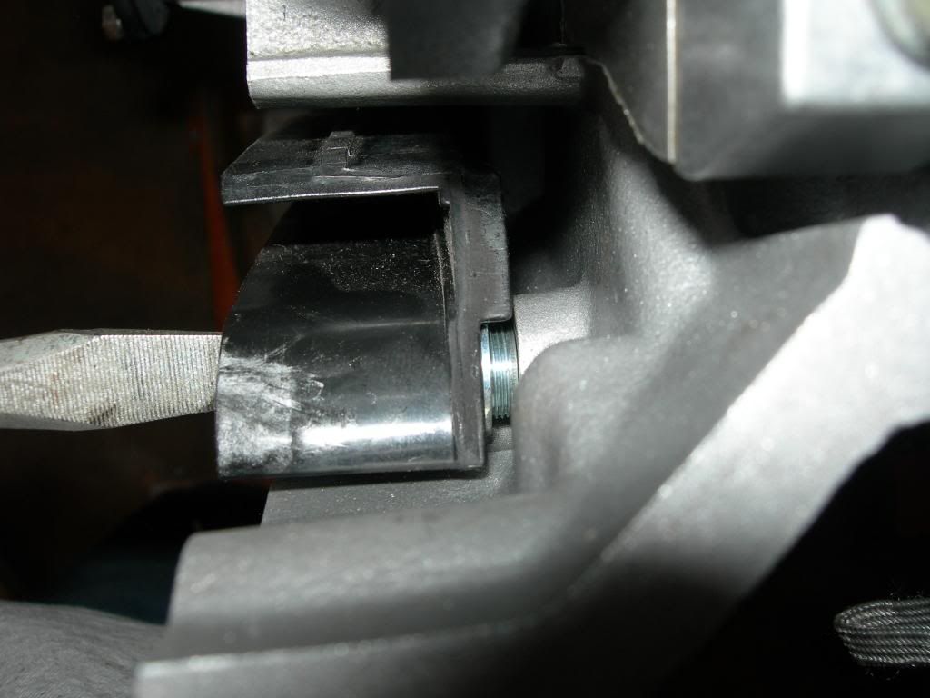

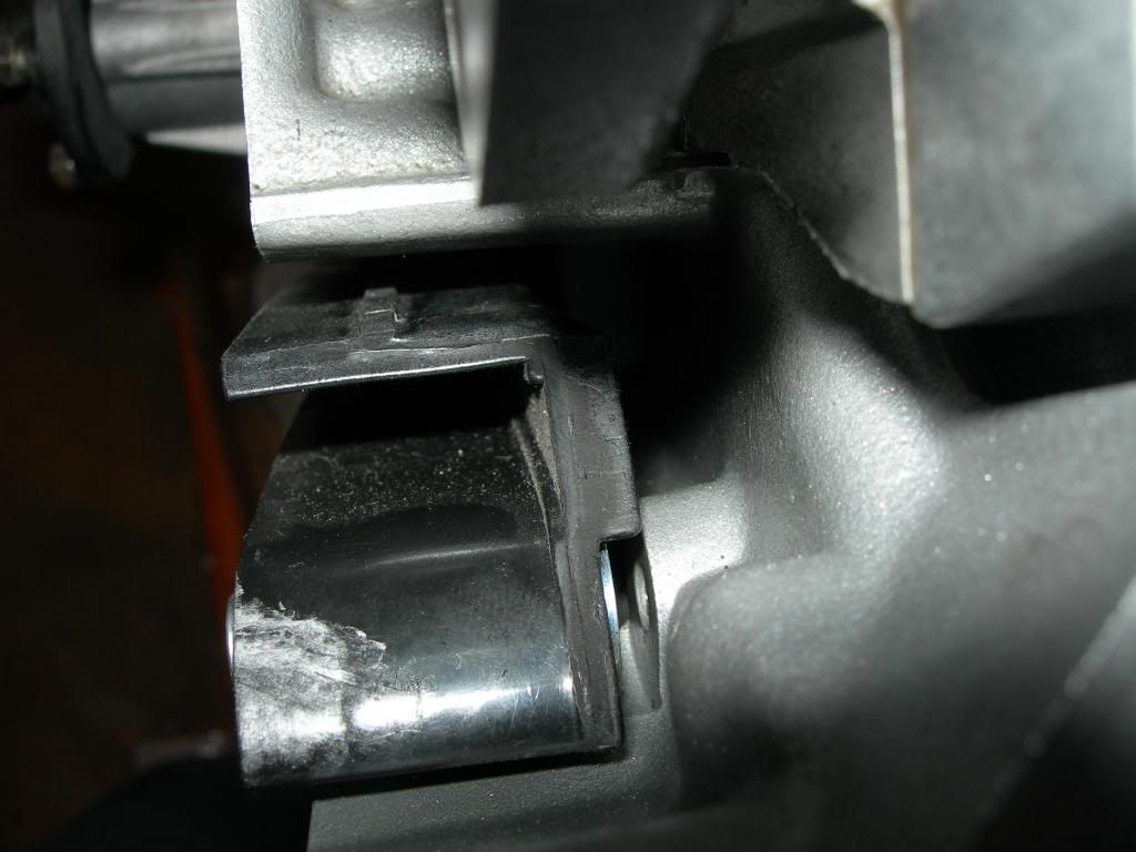

Don't forget the new correct bolt for the right side guide rail 07 11 9 919 629.  It is 5mm longer than the original to compensate for the adjusting screw.  And if I was trying to do the job in one day I would have a spare one of these 07 11 9 919 941.  I have had to use vice grips to get it off an m42 I have broken down.
i think i missed something here, what is the adjusting screw you're referring to that's different from the factory setup?

« Reply #31 on: December 18, 2011, 09:26:15 AM »
Quote from: bflan2001;108983
Here are a couple of pictures to show what I am talking about.
http://i233.photobucket.com/albums/ee215/Stan141/m42rebuild036.jpg
http://i233.photobucket.com/albums/ee215/Stan141/m42rebuild037.jpg

thanks for the info, seems kind of stupid of BMW to sell an updated part without a necessary updated bolt to match. usually pelican will tell you that kind of info but i guess it's not common knowledge. what about the second part number you posted, 07 11 9 919 941, where does that go?

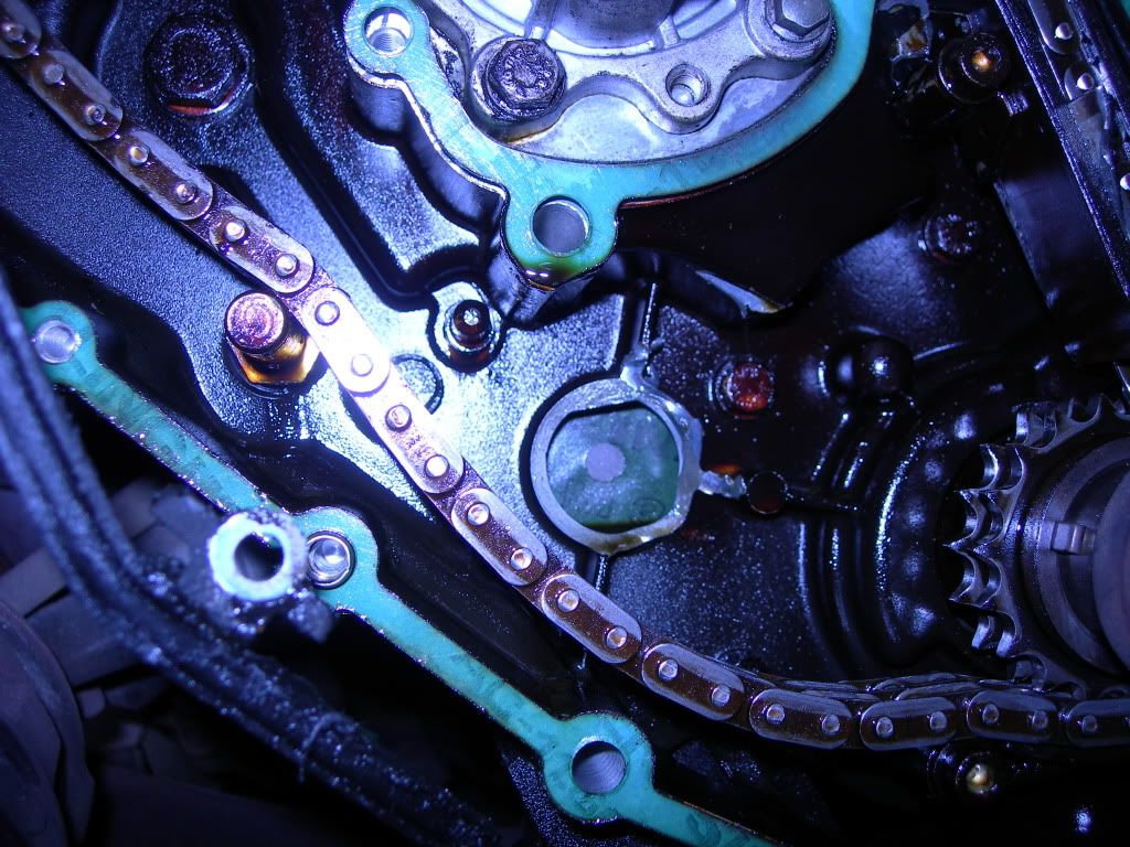

The pulley itself is fine oddly enough. What is broken is the actual timing case itself. I want to replace it but I don't know if I am going to have to remove the head and the oil pan and stuff. Does anyone know of a write up?... or maybe someone can give me some details of the job if they've done it before.

Ah, I see. Now I think I understand the pictures. The case broke where the pulley mounted to it? That does suck!
As far as pulling the head and oil pan, I can't see that as being all that much more work, given how deep you are into the engine now.

OK, here's what you do. Get an M44 timing case (used ones are cheap, just ask around here, r3vlimited & bimmerforums). It does not even bother with that stupid sprocket. Instead, it has a plastic guide rail there. It has been discussed in here, and is a direct swap as far as I am aware. I would have done it had I known about it back in July when I pulled it all apart.
You should ask around in here about it. A few folks have done it & may be able to give some pointers.
I am glad that you found the issue before anything really serious happened. It is a bummer, believe me, I know. My oil pump ate a chunk of timing chain in 2006 and exploded part of the timing case.
