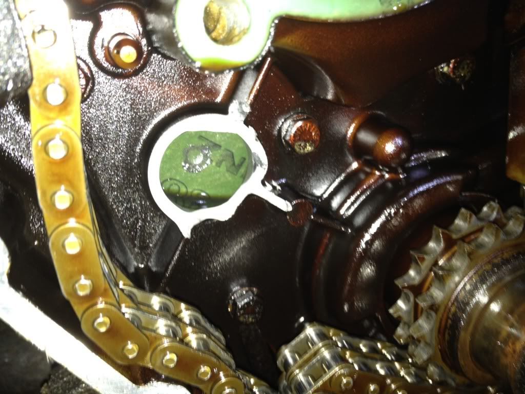

A buddy of mine and I just removed the upper and lower timing case covers and it took about 5-6 hours. He's had some experience and it was my first time. The loosening of the crank bolt was hilariously barbaric but pretty easy following the Brendan Purcell instructions. That's pretty much what I followed the whole time (and it's really nice and straight forward) but he doesn't say anything about removing the A/C compressor and the bracket which more or less has to be removed in order to pull out the lower cover. In the pictures it doesn't even look like he had one anyway haha.
Ok. Here is what we found. I'll go ahead and show you the good news first.
The idler sprocket /deflection wheel / tensioner sprocket is totally fine! In fact, it looks pretty new.
However, there was a slight issue that was immediately noticeable when the lower cover finally popped off. The bad news:
You may be able to tell my dismay from the picture.
So. This is where I am at now. I was crossing my fingers so badly to get back on the road again soon so this is pretty disappointing. So this thing was literally just bouncing around in the timing case and that's what was making all the noise. Sounds kind of crazy to me I think. I haven't researched this yet, (I just finished with exams today) but is the timing case a pop-off and replace kind of deal or what? Is this a head removal job? Should I just forget it and go for a new engine? I need some help I think.
On the plus side, the BMW dealership called today and told me they didn't have the idler sprocket so they totally refunded me.:p However, I have a new timing chain, rails, and upper and lower timing cover gaskets on the way from FCPEuro. (Awesome customer service from what I can tell btw)
I'm hoping this is just a new timing case deal. I miss my car.

I think I have a post that got caught in the filter but when it's up, you can see what I found in my timing case...

Quote from: PeabnutBubber;108969
Do tell!

Extended tensioner slides in w/o force???
« Reply #29 on: December 17, 2011, 05:51:41 PM »
I approved it.  Maybe a little Elmer's will fix that up?
Glad you caught that before the motor munched eight valves...
