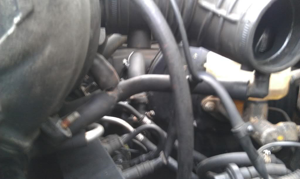

Checked all the hoses all seem good! Checked the wire from the thread an its not plugged in! new fuel pump wasn't that! Not really sure what else to try! :(

Did you remove the upper half of the intake manifold and check all your ccv/icv hoses?

Checked all the hoses i could find all seem good replaced a few an still does it! The gas tank has been replaced lately wondering if a fuel vacuum line could be messed up?

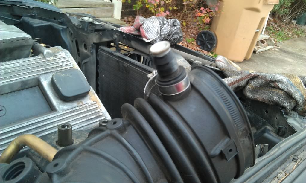

Removed the intake manifold an checked all the hoses under there all seems to be fine. AFM meter seems fine too!?????

Did you check closely for cracks in the rubber intake boot? It's pretty common for them to split on the AFM end along the ridge where the hose clamp sits. Also check the port and plastic elbow on the bottom. Does it start hard when warm?

checked all the afm hoses an stuff! Doesn't really start hard when warm either!
