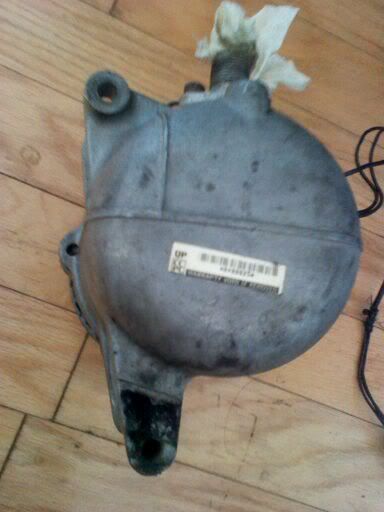

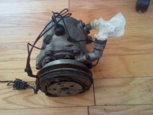

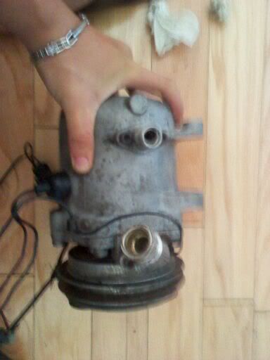

i have a e30 91 318i with m42, just buy a e36 m42 compressor brackect.
and dont know if it will fit right  @.@....???
can someone help?   and im not sure i even buy the right compressor, even thought  the compressor came off  a e30 ,with the v belt pully :confused:

No way that'll fit on the e30 setup. My compressor is bolted to the block...the belt is tensioned by an idler pulley.
There were many different types of compressor on the M42 over it's lifespan.  There are also three versions of A/C drive.
Post a WTB ad & see who has the goodies...I'm sure you'd get a bite off that.  R3v is a good place for that too - lots of e30 guys are pulling M42's.  You'd get a great deal from me if I was doing that.
