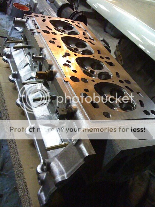

BTW, i picked up a brand new head for my M42 at 300 Euros (instead of 1200!!!), now its cleaning valves...

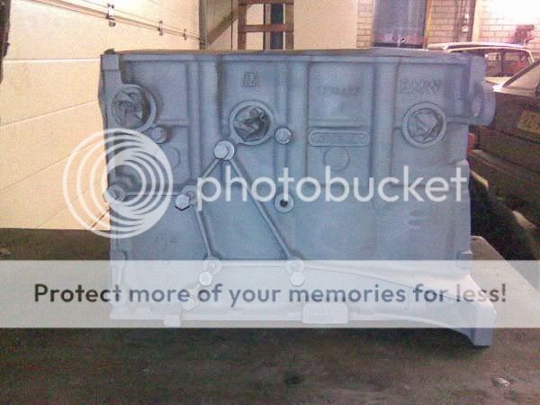

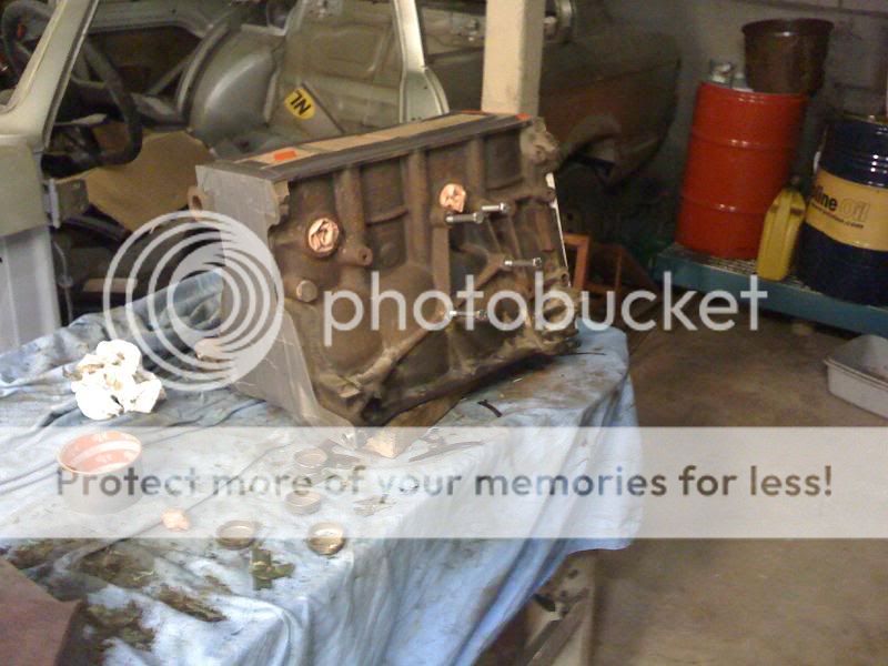

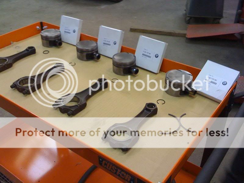

Hi all, finially time to work on the car/engine again: pistons, grinding the valves in my brand new head and getting the case ready for sandblasting
Froos
  • Posts: 300
Froos
« Reply #52 on: December 13, 2008, 05:59:18 PM »

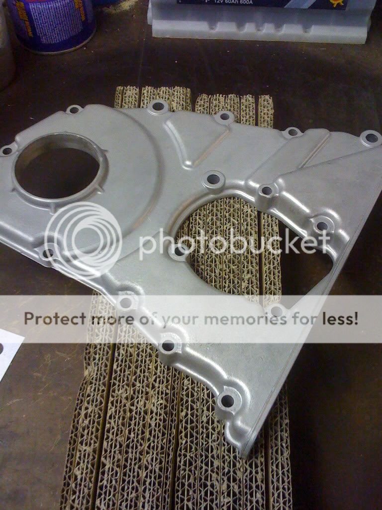

sandblasting done

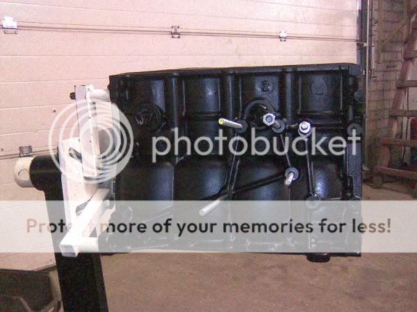

finished all the cleaning, now its reassamble and getting the ITB's to work see:
http://www.m42club.com/forums/showthread.php?t=7609
Best part of the day reinstalling the oil pump

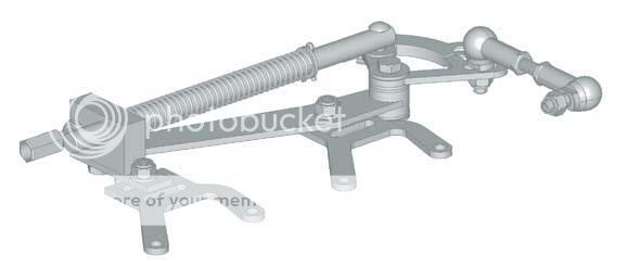

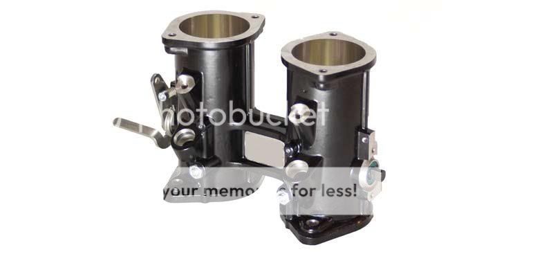

ok just got back from the tuner. Ive decided to tune in 2 steps, because that way I can spread my investment a bit and drive around with step 1.
Step1
Ø45-Ø48 tapered DTB's
fuel rail
linkage
20 Liter airbox
fuel pressure regulator
Raising compression
Reprogram std ecu and dyno
Togehter with all the stuff I bought already and modified
btw ill be using the injector holes in the DTB's instead of the ones in the intake manifold.
Step2(after saving $$$ for months)
Ditching STD ecu,coils,air mass meter(barndoor),lamda and wirering and replacing it with custom electrics

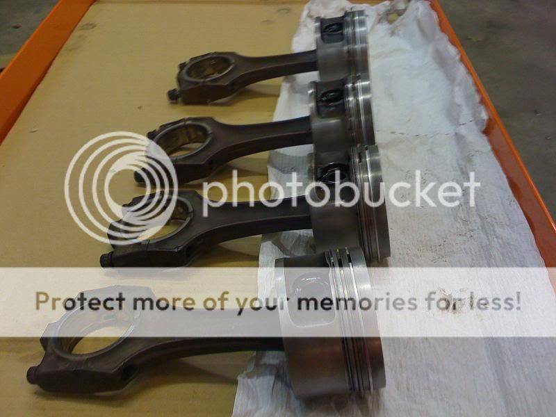

well excellent day today, installed the freshly balanced crank with new bearings and oil jets (really wonder what will happen it they get blocked), balanced pistons/rods to exactly1087gr each than installed the pistons and lower timing case...
« Last Edit: February 07, 2009, 05:05:55 PM by Froos »
