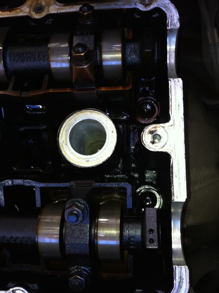

Ok.  I had a chance to take the valve cover off today.  The teeth on the cam gears were not sharp at all.  They look like pictures of what others call "good shape".  From what I could tell the timing looked to be good.  The lobes of the cams furthest from the front of the engine looked to be pointing at each other.  The arrows on the sprockets also looked to be pointing in the same direction also, the bolts that held on the cam gears looked to be centered in the holes. Here are some pictures of what I found.
The rear lobes of the cams
Pic of the teeth.
One more close up.
From the top.
I took more pictures and can easily take the cover off again if there is something I'm missing that could help diagnose the problem.
Is it possible that the sprockets could look this good and the guides be so bad that they are causing the problem?  Or could the problem be unrelated to the chain guides?

Based on the plastic and metal chunks in the pan from your other post I'd still vote that the guides (and possibly chain) are degrading. Someone could have replaced the cam gears and not replaced those items. If I were you I would tear down the front of the engine based on the noises you are having.
Good news is that your cam gears are in decent shape.

it might just be the picture, but it looks like one of your cams jumped several teeth. The squares on the back of the cams are supposed to be aligned with each other aka at the same angle as each other. If this is the case I would just look into picking up a used engine. It could just be the pics though, check the squares
« Last Edit: October 10, 2010, 12:43:52 PM by nickmpower »
