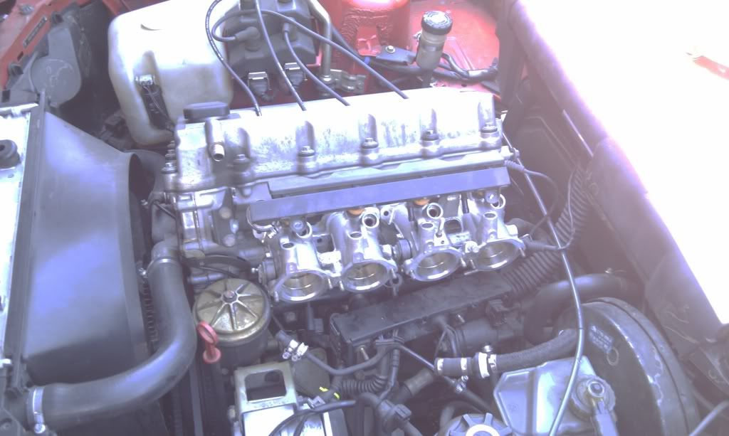

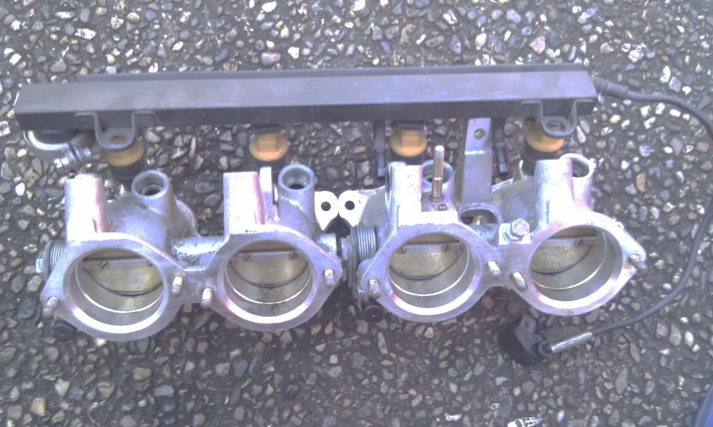

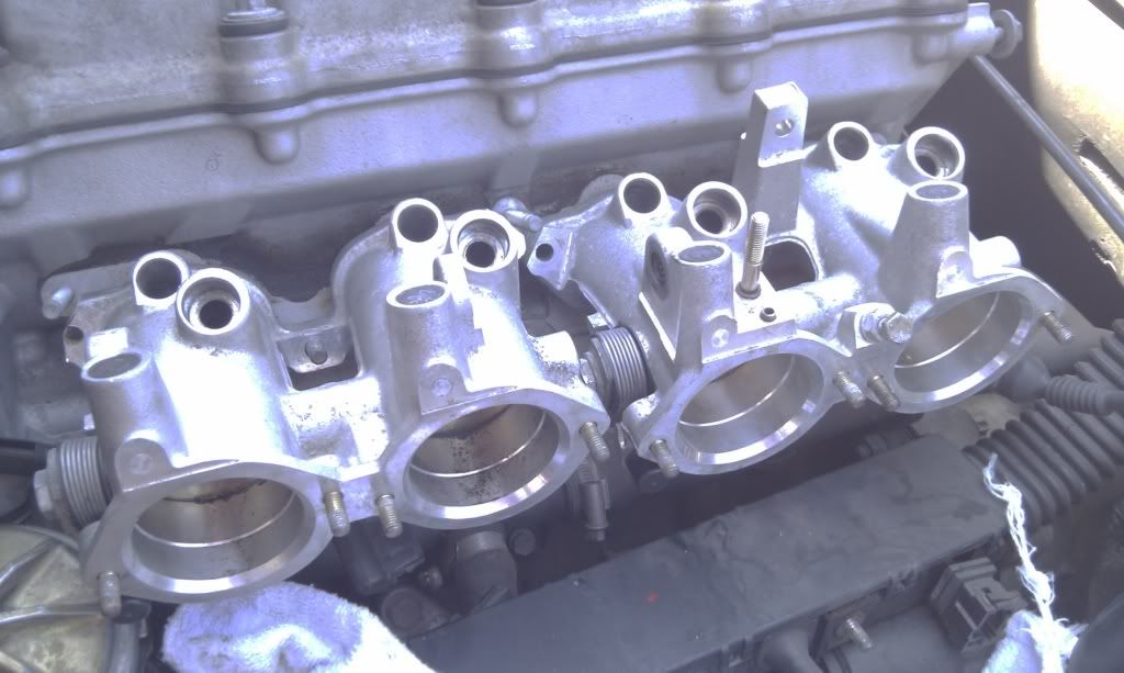

I thought i would start a biuld thread for my itb set up.

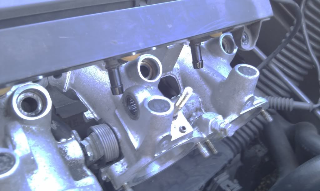

im using 50mm itbs from an e36 m3. all iv done is pull the manifold off to trail fit the itbs and make a 'to do' list. i was thinking i will block of the heater hoses so i only have one pipe going from the block to the bottom of the radiator.

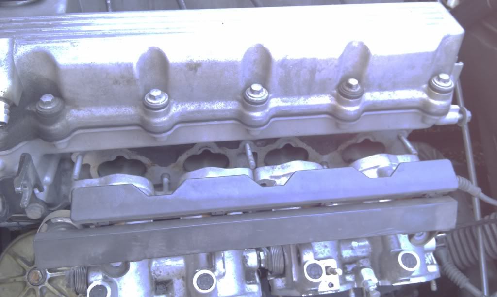

i need the modify the fuel rail because the return pipes hits on part of the tb
they are the main things, other little things like grinding the corners off the itbs should be pretty easy
so there is a little bit of work to do. any surguession/comments would be greatly apreciated.

I'm making some popcorn to see this happen...other than that, I'm most likely going to be useless.
I'd just bend the fuel rail nipples personally, but I'd recommend making a custom fuel rail.  The fittings are available out there on teh g00glez.

well i was thinking of making a new rail because i wana to run an adjustable fuel pressure reg
ITBs
« Reply #3 on: August 21, 2010, 09:51:21 AM »
I've seen some beautiful ones in alu.  Alternatively, could you shorten the original M3 rail?

Haha well the top 3 head studs dont line up but ill make them fit haha i wana get this done by mid september

pulled out the old hack saw this morning and cut the itbs down to fit
still need the drill the bottom hole in the itbs because there is a collar around the bottom stud on the head. other than that im getting my mate to do some work on monday/tuesday so another update then
