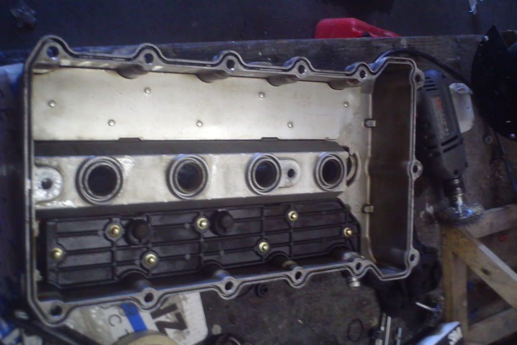

valve cover

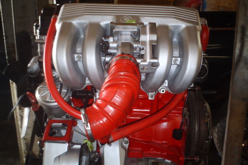

started vac lines with the mess under the intake delete (thanks to the guy who posted that 4 us on here, its ingenious)

afm

Wow, this is looking great, manchuk! I like the attn to detail on the motor, brackets and covers. Looking really sharp! Is that intake boot oem & red tape? Where did you pick up the head studs?

and it is self fuseing silicon wrap on the intake boot, it makes a solid layer of silicone once it overlaps it self
