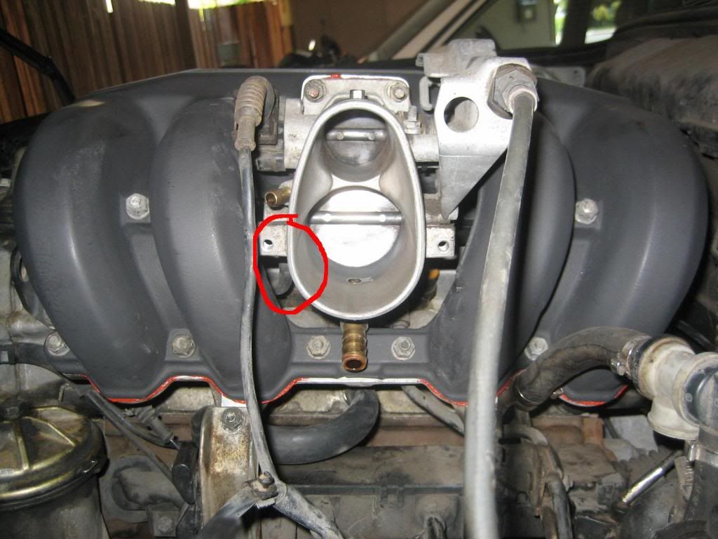

« Reply #5 on: May 30, 2010, 11:40:44 AM »
The vacuum hose from the FPR plugs into the side of the throttle body in a really stupid location. Hard to reach and easy to overlook.

« Reply #6 on: May 30, 2010, 11:45:04 AM »
Thanks Justin! I´ll go take a look at it now. If it´s not then i´ll take the other set of 4 injectors to get tested and replace the ones i just put in.
Ok, it looks like it´s connected, so that´s not the problem. On to plan B...
