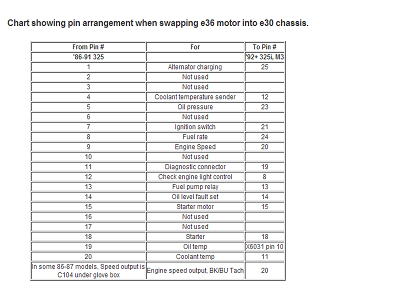

i'm going to put the ecu and the engine harness from the e36 m42 on my engine to but which wires did you cut at the round contact next to the fuse box

NisseJärnet, please do post pics and share with us the wires you needed to cut/splice to make it work. :)

« Reply #10 on: July 02, 2010, 05:33:23 PM »
maybe this site will help to connect the wiring-harness
http://www.akgmotorsport.com/usm50swappins.php

nice link,have the same swap, can u post pics of the location of these pins where i can jump them, coz i havent got the temp and tach connected yet,tq!
