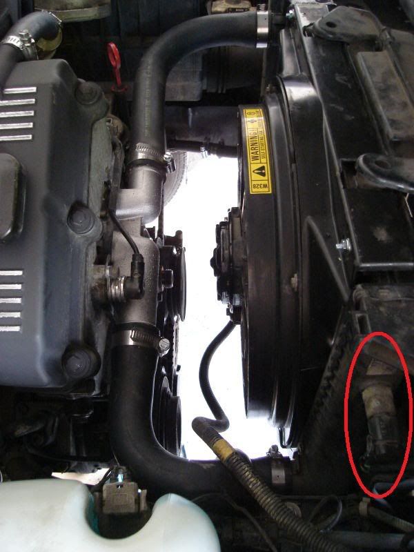

but the switch goes in the radiator huh? i can probably handle that... just didn't feel like taking the bumper/valance off again just to do a switch when i usually am keeping a close eye on the gauges anyway.

Its in the side of the radiator near the passenger side headlight. Its a 2 minute job. Don't even have to drain the radiator.
