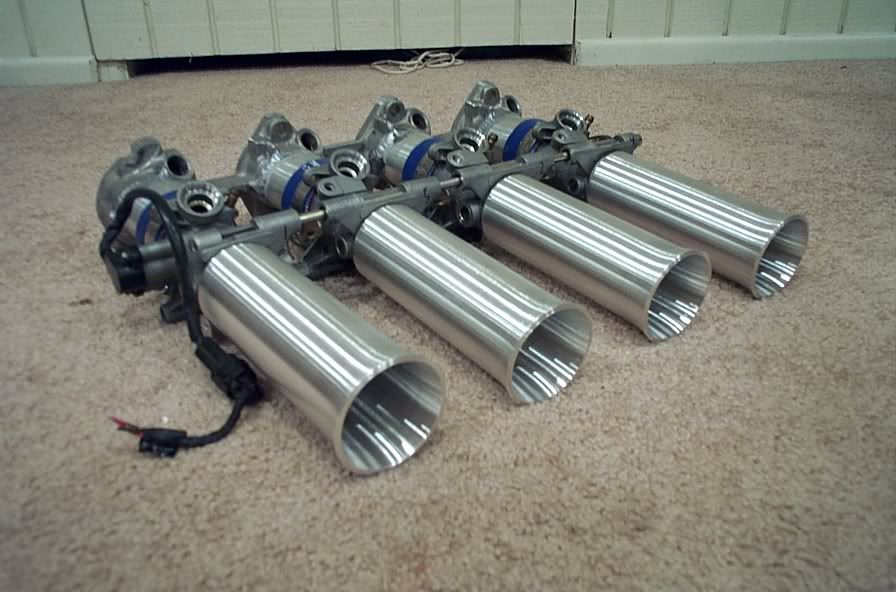

Here is the ITB setup I fabbed up for my M10 powered 2002.  A similar setup could be made just as easily (wasnt easy though) for an M42.  I used 38mm GSXR600 throttlebodies which will support PLENTY of power.
I am going to re-do the velocity stacks because I could get enough flare.  I will be making billets.

they're cool! be nice with some flared trumpets on there! those trumpets are pretty long. is that the m10 original manifold you've used?
what you doing for fuelling?
and whats the m10 they're going onto?!
nice work!
you in the uk too? u/n seems familiar?

Yes, I used the manifold from a e30 318i (m10) as a base for my manifold so I could use the injector ports.  I'll be using megasquirt to handle the injection, but that wont be for a while as the car is still in pieces.  The motor was built when I got the car but the PO told me that it has 10.5:1 CR a schrick 304 or motorsport 300 cam and alot of port work.  It had 45 webers on it when I got it.
I'm in the states.
