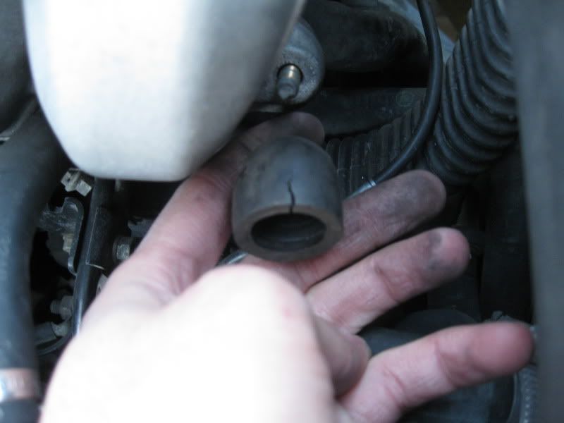

Okay. Might be on to something here. I just read up on how the idling system in these cars works, and this is starting to make more sense.
I did a few tests with the ICV.
1) Started the car as usual, it idled fine. I then removed the 2-pin connector for the ICV and the car simply died. No erratic idling, hunting or anything.
2) Started the car with the ICV disconnected, and it started then simply died.
I tried testing the ICV with the car's power by turning the key to position 2 with the ICV in my hand, also with the connector plugged in. I could feel a very very faint vibration from it. I intend to clean it and see if that will make a difference.
HOWEVER, upon further inspection I noticed that the intake hose going from the rubber intake boot in between the air filter and throttle, on the end that connects to the ICV, is cracked.
Here is a picture
This is probably assisting in creating the problem isnt it?

« Reply #11 on: January 11, 2010, 03:49:11 PM »
Those lines have to be perfect...no leaks.  I've taped them with a little electrical tape for a quick fix, but they should be replaced.  BMA, Pelican or a BMW dealer can supply them for you, they're not that bad.  You could also use a length of heater hose, though it's not rated for vacuum.
You could upgrade to silicon hose too, I suspect that would outlast the car.
