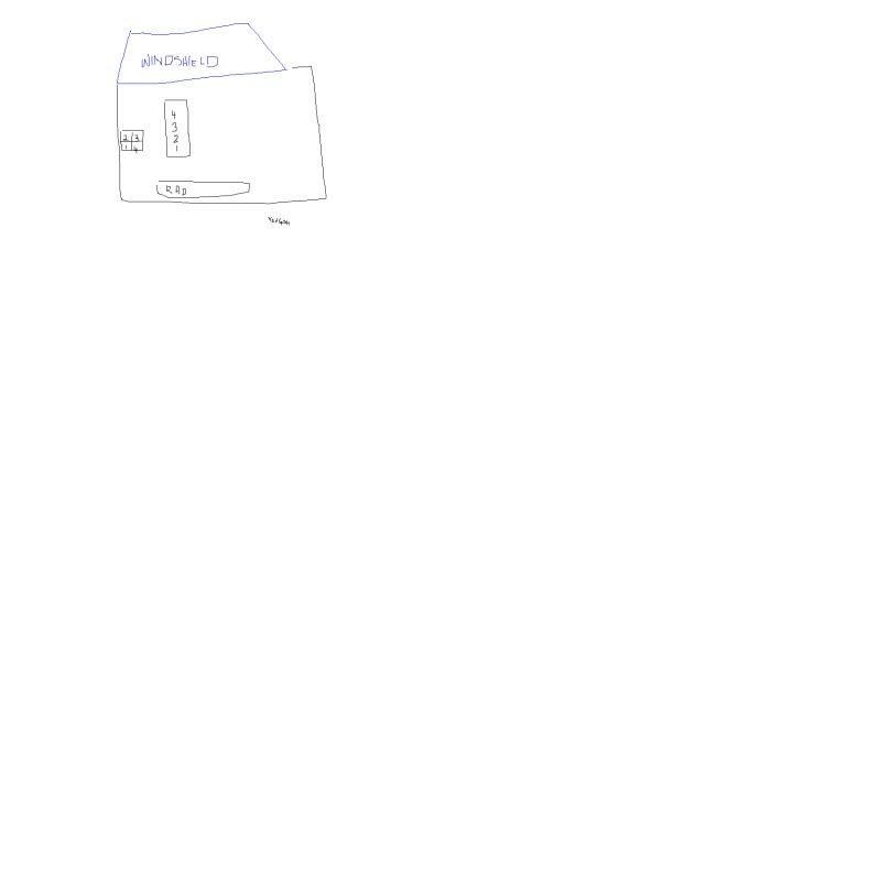

1. what are the plugs on my car suppose to be really gaped too?
2. Since autozone say i crossed the wires to the plugs, can someone here supply me with a Picture of where and what wires plug into whitch plugs.
Don't recall off the top of my head. However, dual diode plugs should be pre-gaped as it's not as easy to fit a gaping tool in there. I could be wrong, but I doubt it
There should be a black cover at the coil pack where the wires attach. It should have numbers on it. 1, 2, 3, 4. If not, while standing at the passenger side looking into the engine bay the coil pack will assume the shape of a square. The bottom right (closest to you on the right) will be #1. Bottom left #2. Top left #3. Top right #4. The matching cylinders go from radiator to firewall 1, 2, 3, 4.

oh an put your old plugs back in and see what happens. nice picture btw picasso

Quote from: dvmotorsports;83212
but is that pic right, the coil and numbers
and thanks for all the useful info
also the plug has one diode
« Last Edit: December 18, 2009, 09:30:31 PM by 92BMW318is »

No. The motor is entirely backwards. And your coilpack doesn't sit inline
Engine
  34
  21
Fender

Quote from: dvmotorsports;83214
Engine
  34
  21
Fender
im talking about just the coil and spark plug wire leads,
are the coils and spark plugs numbered right, do they match up like i matched them  in the picture, as in the first coil closest to the windshield lead to the first spark plug input closest to the windshield, so on and so on.
|windshield|
Coil|1-Spark|1
Coil|2-Spark|2      |engine|    |intake manifold|
Coil|3-Spark|3
Coil|4-Spark|4
|front bumper/ radiator|

92BMW318is
  • Posts: 244
My BMW keeps back firing, at low idle speeds, i wanna punch it
« Reply #7 on: December 18, 2009, 10:10:36 PM »
okay so i looked at the engine and this is what the coils look like on my car and this is how they are positioned is this the right order
dvmotorsports
  • Posts: 523
« Reply #8 on: December 18, 2009, 10:14:06 PM »
Bingo!
