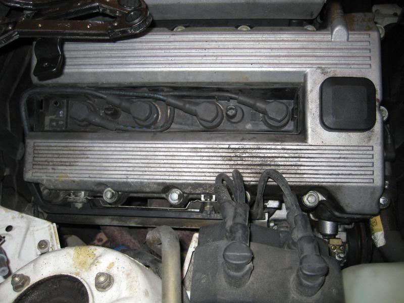

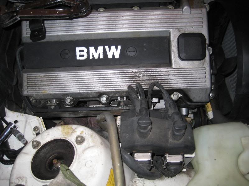

Then remove cover to access plug wires
Then pull the plugs off the ignition coil

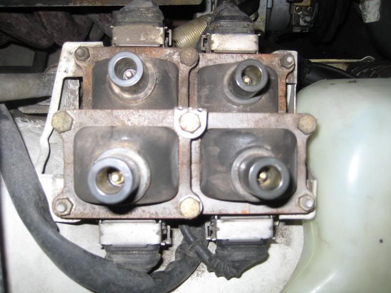

Take the plastic cover off the coils

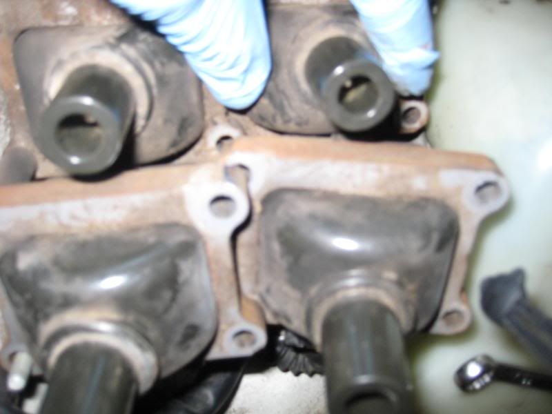

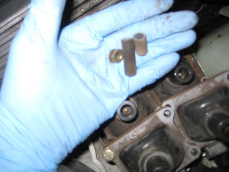

Undo the bolts and keep track of the washers!! Theres some hollow tubes that help the coils stack on top of each other.

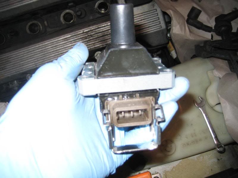

Removing coil.  I only replaced one of mine.
New coil.  Doesn't exactly look like the original.  The sliding lock tab is upside down.  You could insert it the opposite way but that would require a dremel and I was lazy.

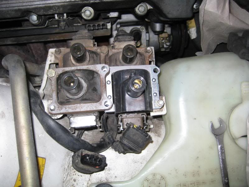

Install new coil

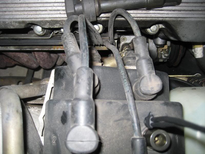

Tips: keep track of the order that you remove the wires.  I know the OEM wires are numbered but the new set that I bought was not.
