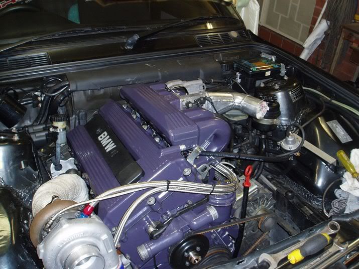

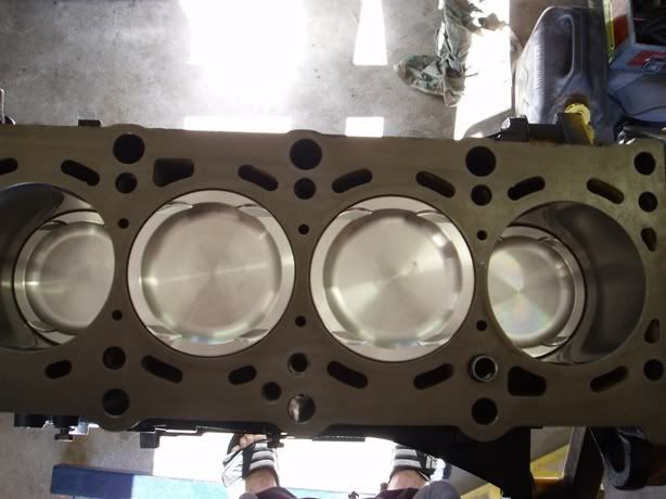

Here is a photo of 8:1 pistons from my m42
Also a photo of my m42 turbo, its currently gettin dynoed and i should be getting it back tomorrow
I will probably do a write up over my uni break holidays, ive been working on this project since december last year.

well dang, care to share any info? What manifold are you using? Thats the thing holding me back at the moment :(

general info:
Pistons:                    8:1 JE Pistons from top-end performance
injectors:                  570cc
turbo:                      T2871R
ignition coils:             Bosch (not sure exactly)
engine management:   Wolf3d Ver4
head gasket:             Cometic
exhaust:                   Custom made manifold, 3 inch dump pipe, high flow  cat, resenator, muffler
intercooler:                From lancer evo (dont know which one)
fuel:                         Walbro intank pump, rising rate pressure reg
Clutch:                      Custom made clutch
also have boost guage inside
soon to be fitted an gredy electronic boost controller
The manifold was custom made for me and cost me about 800-1000 Australian dollars
im happy to answer any questions

Where are you getting your pressurized oil from to supply the turbo?
