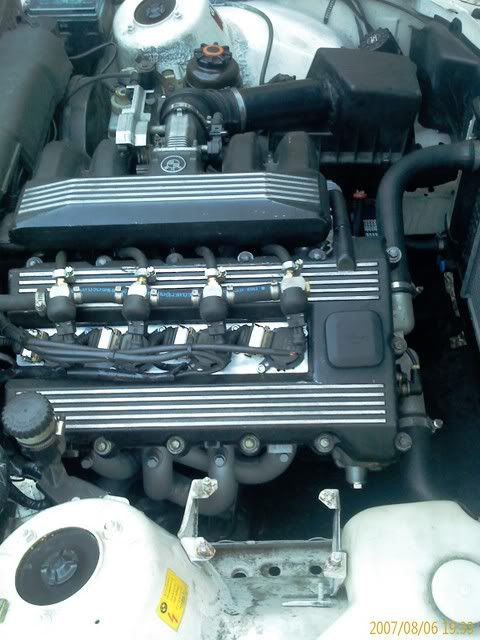

i will take some pictures in a few days, i'm kinda busy right now.
How do i operate it? Well, it's all automatic.
The car normally starts on petrol (gasoline). when a water temperature reaches 40 °C (don't know how much F is that), LPG ECU cuts of the fuel injectors and opens the valve to let lpg gas go onto lpg injectors. it reads from car ECU when and for how long each lpg injector has to be open.
If i want to, i have a button in cockpit where i can select on what fuel i want to drive. one simple touch of a button and car runs on gasoline. again, one touch and it runs on lpg. All happens within a second.
I have a lpg reservoir instead of a spare tire, so it doesn't take up space in the trunk.
pics in a few days of everything.

So your lpg tank is rather small. What kind of mileage you got with gas or the european way how many kg/liter it does take per 100km.

« Reply #32 on: September 04, 2007, 11:20:59 AM »
tank iz 55 L.
my avg. cons. is around 12L/100km. usually, i make 300 km and then go for a refuel. just in case ;)
but since there is a lot of lpg stations in zagreb(city) and croatia, i don't have problems with low mileage. and there is always gasoline for backup :)

« Reply #33 on: September 04, 2007, 12:38:34 PM »
pics of my lpg setup
sorry about the crap quality of some of those, you get the idea :)

« Reply #34 on: September 04, 2007, 01:27:16 PM »
Tim! -> I have the same romano kit on the shelf... I was thinking about installing it, but it seems, that I will build up LPi installation based on VEMS and some injectors... First I need a pump that will give me 5 bars of constant pressure /required for the LPG to stay liquid/...
Here in Poland we have 1ltr of LPG for about 0.55 euro... But the gasoline is about 1,1 euro.
About tanks: I know a guy who transports friends who buys cars in Germany. He has 318is combined with 3 tanks...  He has two 80 liters tanks in the trunk and one 60ltr tank in the wheelspace. And of corse stock gasoline tank.
When he transports 4 other person, he is running on special springs at rear suspension...
But he can do 1500 km on the LPG till it ends... With the average of 140km/h speed :-)
560 km in 3 hours and 5 minutes completely legal!!!                  I love german highroads!!!
