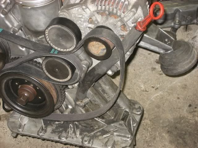

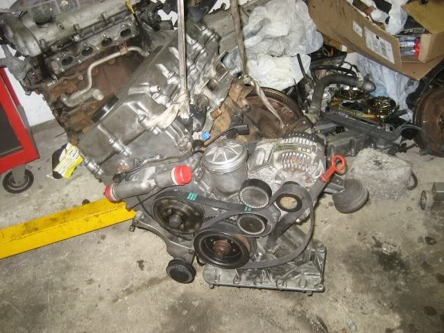

« Reply #4 on: April 25, 2008, 01:35:51 AM »
Here are some pics of mine. I have no idea why i cant post up any pics - it fails me every time...
In any case, I will add the top of the dipstick tube to the hose and extend it exact amount needed for the dipstick to be touching the oil and then I will take it from there. It seems to be sealed up otherwise.

« Reply #6 on: August 25, 2008, 03:41:22 AM »
Hey guys, here´s a pic of my solution to the dipstick deal, it´s been bent in an "S" shape, and bolted to one of the power steering pump bolts with a clamp.
It has enough clearance all around, it is a little harder to pull out, but the reading is accurate.

was there ever any resolution to getting the oil disptick & tube assembly fitting any better after performing a serpentine conversion?
Also, are there any better pictures of the front of an M42 after the serpentine conversion has been completed?  I've been trying to look for something online to see the entire pulley/accessory system layout, but have had no such luck finding a good image or pic....
