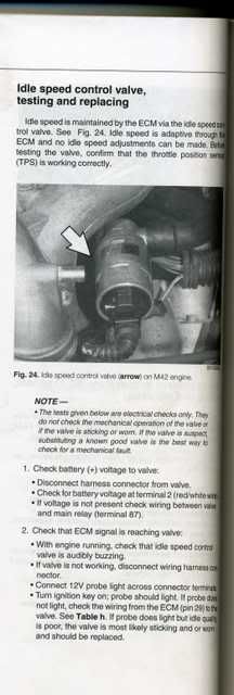

Have you checked the ICV yet ?????

icv= ??? whats that??? sorry kinda newbie with the short names

Get a bentley manual if you don't have one already. It is the bible for these cars.
And search is your friend.
good luck
