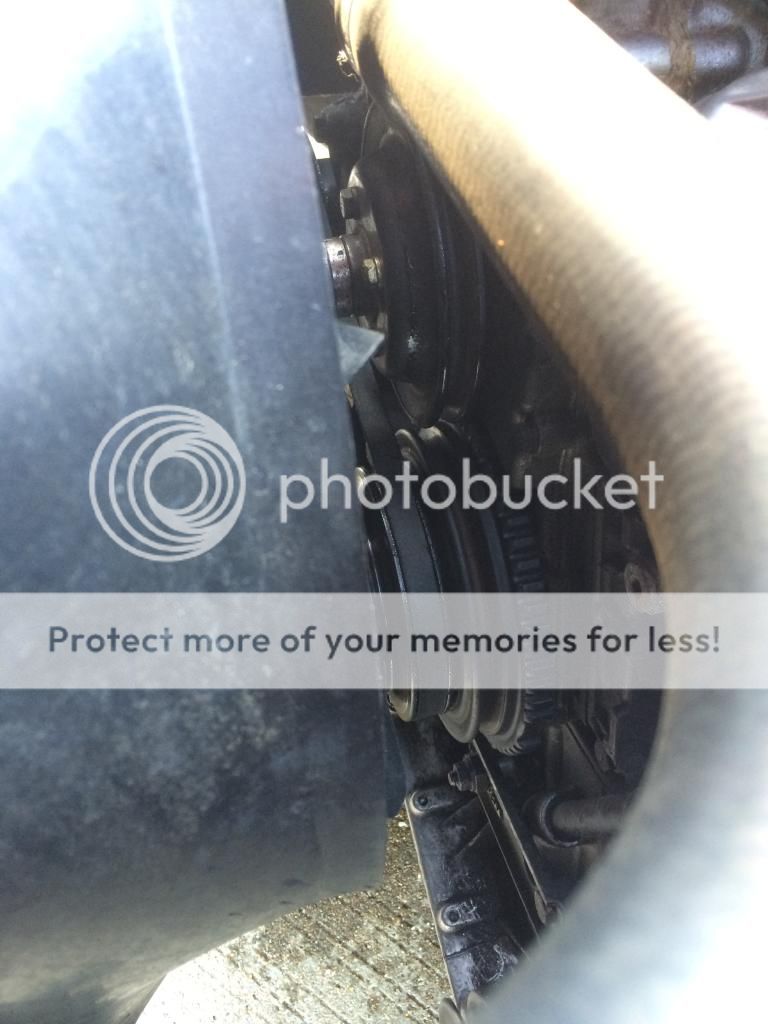

I've had the car 2000 miles so far with only one issue (other than the idle) - It ate a waterpump on the interstate 72 miles from home. I was coming home from Indianapolis on July 6 and i heard a noise like i had run something over and trapped it under my car. I couldn't figure out what the problem was, but the car still felt fine and had good power. I had dark glasses on and couldn't really see the dash lights, but luckily a few minutes after hearing the noise i saw the check engine light was on. Immediately noticed every other warning light had come on and my temp was in the red. Thankfully I was able to safely merge into a rest area within a few seconds of noticing the problem. Had i been a few miles down the road i'd have been stuck in a construction area with no shoulder for a few miles. Pulled into the rest area with a trail of coolant behind me. The car proceeded to puke coolant from the waterpump for about 15 minutes.
Took a look around and noticed that the belt had snapped. I'll bet that's what I heard under my car.
Even though by a fluke I had a full tool set, jack and jack stands I didn't have any spare belts and no way to get to a parts store that would more than likely be closed on a holiday weekend sunday night. Bit the bullet and had it towed home.
New water pump, thermostat and all three belts and we're good to go. I was worried about the head but everything looks good. Had a shop check it and they gave it a thumbs up and I haven't noticed any coolant in the oil. I dodged a bullet there!

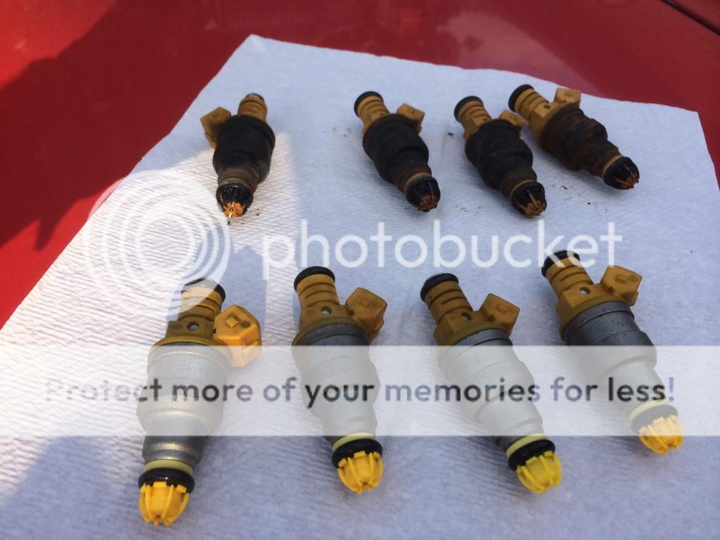

Small update - still chasing the idle issue.
Swapped ecu last night with no success. No change when removing fuel pressure regulator, idle control valve, or both. No change in idle quality by adjusting idle speed screw either. At this point it's gotta be injectors, coils/wires, or timing/cam issue.
Does anyone know how long it takes an ecu to learn a new O2 sensor? I still need to replace with a good one (even though it didn't make any change in the idle quality.) I plan to use a good m20 sensor and splice m42 wire harness. Seems like sensor is the same and need to save as much dough as I can.
At this point it's gotta be injectors, coils/wires, or timing/cam issue. I need to get my mutstang injectors rebuilt and installed. I plan to install the valve cover gasket this weeknd and will check the condition of the timing chain and sprockets as well as if the cam timing is out of spec.

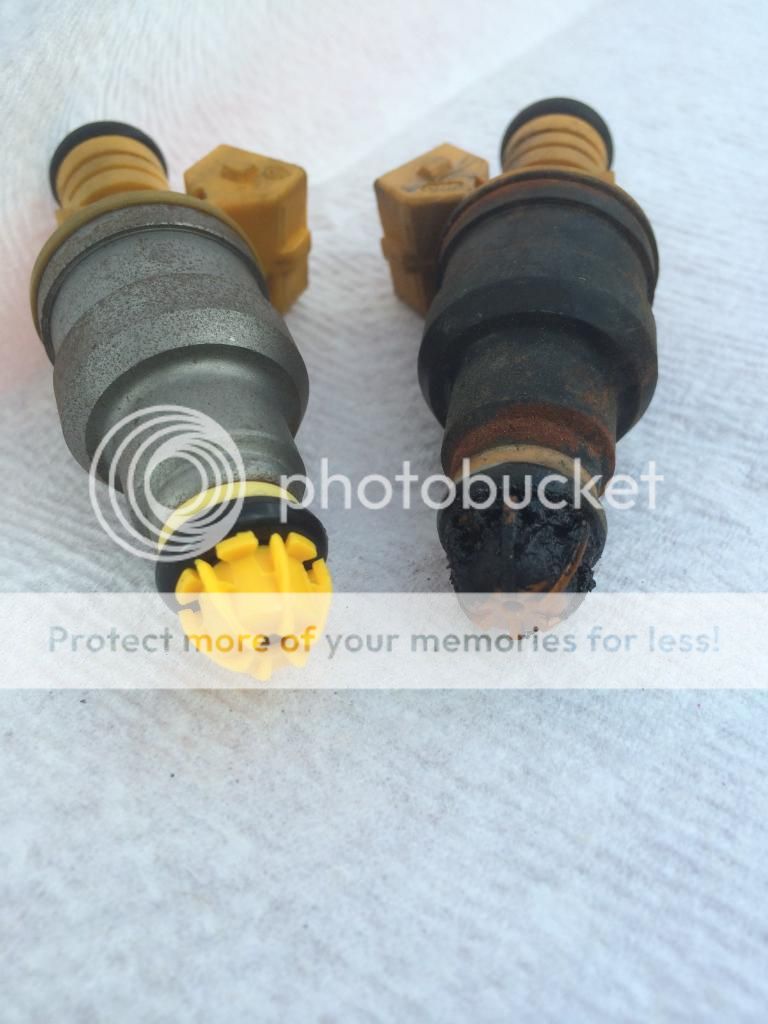

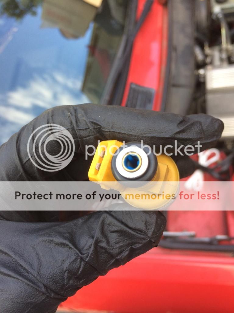

This past weekend I changed the oil, bled brakes and clutch, and replaced fuel injectors with Mustang 19# units. I had been having problems shifting from neutral to first intermittently when the transmission was cold and figured the first step would be to bleed the system. hooked up the magic bav auto pressure bleeder and went to town. got a lot of air out of the system and flushed some nasty nasty fluid. Shifts a bit better now from N to 1, but still not what it's supposed to be. I'll probably do a trans fluid flush sometime soon for the peace of mind and then will do shifter bushing (and probably guibo and trans rear seal while I'm in there)
I'd been dragging my feet on having my injectors cleaned, but i finally got them sent out and carved out some time to do the swap. I'm glad i did, i'd just had the injectors out a few thousand miles ago when i did mess under the intake and they were super nasty again. I'm not sure if it's placebo or just the fact that the injectors are fresh and clean, but i feel like the car has a little more power down low than it used to. Driving in 1st/2nd in my parking garage (or other low speed situation) is a lot more comfortable too -doesn't seem like the engine struggles anymore. All in all it's a pretty cheap mod and i'd recommend doing it if you want a project or if you're doing mess under the intake and are in there anyway. I used MEPEH from R3V to do mine and it only cost 20 bucks for the service...super deal. Link to his thread is below.
So still trying to chase the idle issue. At this point i'm thinking timing. still need to pop the valve cover gasket off to inspect. Part of the issues is how the exhaust rattles, and at this point i'm almost wondering if the idle isn't actually that bad and the exhaust rattle is amplifying the problem.
