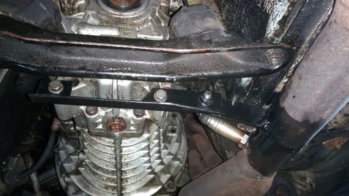

It has been a long time ago since i posted something but a lot has happened.
After the first track weekend in 2018 i decided to renew my brake pads. then i found out that my brake cylinders were stuck.
So i had to rebuild my brake calipers. When i removed the cylinder i found out that they were rusted badly. So i put in new cylinders and seals on al four brake calipers.
I also had new steel brake lines laying around witch i never had motivation for to fit them but since i had to bleed the brakes i thought this was the time.
So now i have al rebuild brake calipers with new brake lines everywhere witch was really a pain in the ass. It look likes its painted but it is just wire brushed.
A friends of mine wanted to build an E36 so suddenly a had a lot of spare parts that i could buy.
So i bought a cage a seat and seat belts. The time had come that this would become a full track day car.
It was nicely cut out! Even the brake lines were still underneath it :P
