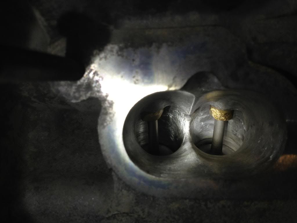

- I had some minor port work done. (Mostly bowl blending and smoothing everything out)

Here is one of the intake ports after port work:

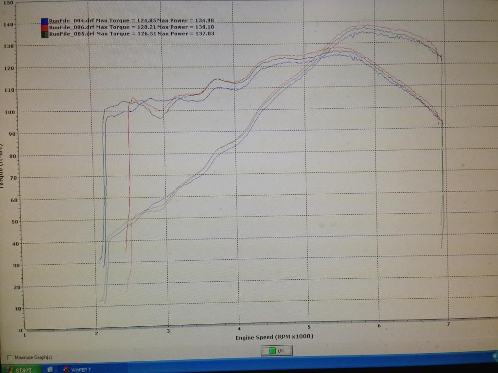

And finally, here is the dyno graph from today (~40 degrees out)
I am happy with the power, considering its a stock motor with minor touches. Having that been said, I have full access to a dyno and would love to move some power up top.
I am open to all suggestions, and I will dyno test them!

I'm not sure if the M42 is under/over rated, but with a claimed 134hp and 127ft/lbs stock, if you use 18% drivetrain loss, that puts my little M42 at 162hp and 150ft/lbs at the flywheel. Not too too bad.

My M42 with +1 SS valves and cams made 142rwhp @ 2600ft elevation 90deg ambient temp, same torque though of 128.  But looks good I wish I had a lot of head work and i know that number would be way higher.  The main issue I run into is that I'm severely choked down by the intake manifold, my car loves to breathe at RPM and so from 5800rpm-7.5k it just hits a wall, shows up on the dyno graphs.
From what I can see, there is absolutely a flow restriction causing the top end to fall on its face.
Oh well, it makes decent power for what it is. I may mess with cam timing a bit, but you can only do so much with limited air flow.
