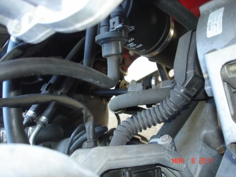

What hose goes here?
April 03, 2011, 09:45:43 AM »
I have a spare vacuum port on the throttle body after I cleaned up the mess under the intake, thanks to
this thread
So, what should I put here? Plug it, maybe?
Otherwise, does anyone see anything amiss so far?

April 03, 2011, 10:12:59 AM »
I think that one goes to the vacuum canister.

April 03, 2011, 10:30:36 PM »
Quote from: DesktopDave;102788
What vacuum canister? Is it necessary?
Forgive me; I'm new to the M42 world and I didn't remove this engine from its donor car.
April 03, 2011, 10:46:34 PM »
There's a purge valve and a vac can under the P/S reservoir on the stock car. If you don't have a vapor recovery system off the gas tank you have little need for it. I'd plug it if that's the case.
Reply #5 on:
April 04, 2011, 07:36:01 AM »
Perfect. Thanks!
Reply #6 on:
April 04, 2011, 11:32:53 AM »
Here's a pix of the canister. It has a short piece of hose (with a one way valve I'm guessing) and then runs to the TB.
